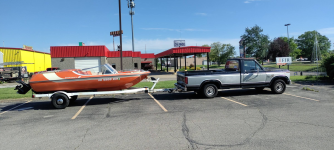

I currently run an RWD 1984 F-150 for towing my 16':
Never have had an issue with the truck itself. I am in Indiana (no salt water!) That said, to help my chances, I did make a few mods last spring after a season with the boat:
-Swapped from road tires to AT tires
-Upgraded the rear end to a helical LSD
I was having snow and mud issues which was the main reason for the upgrade. The only boat towing issue I was having wasn't related to the ramp; my brakes weren't up to snuff when towing from point A to point B. To address that issue, I upgraded my front pads to semi-metallic "heavy duty" and added electric drum brakes to the trailer (I already had a nice controller for use with another trailer). But at the ramp, I turn the electric brakes off, so they aren't a factor there.
All ramps that I use have grooved concrete for plenty of traction.
To the OP: If the truck can haul it on the highway, I'd say go for it.
