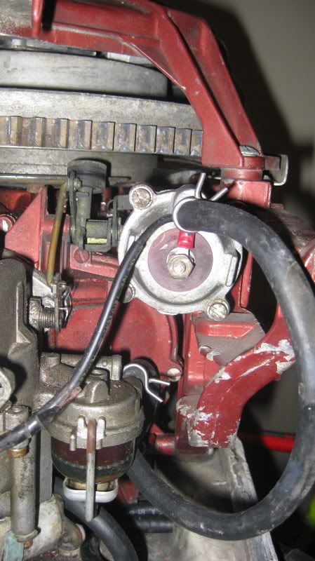

send a pic of your carb. I agree with the others that is sounds like you have an electric choke solenoid on your carb.Which makes me think more and more your motor is a hybrid. Some one put a carb off an electric start model on it and just didnt' hook up the wires. Even with the electric solenoid you should still be able to manually operate the choke with the pull knob. Just manually operate it and forget about the solenoid. you can take it off if you want it won't hurt anything. Send it to me I can use another one.

Anyway, that motor WAS electric start. That's what the "E" in the model number means. The "J" means Javelin. The choke solenoid is the only round thing attached to your carb that resembles a battery. It should have a wire connected to it, but since the electric start was removed they probably disconnected the wire. Either way, it does nothing when the motor is operated manually. The manual choke is just a mechanical lever. Changing it to a newer 12V style is not a bad idea, though, if you intend to convert the motor to remote controls.
You definately have a Javelin cowl and identification plate. I still suspect you have a clone, though. Post some photos under the cowl when you get a chance. Also look for a silver plug on the starboard side of the engine block. It may have the model number of the motor on it. The lower units are compatible to other years, but its very strange that the lower engine cover, exhaust tower and steering bracket would have been replaced. You don't need to chage any of them to convert to tiller steering.

here are some pics...
