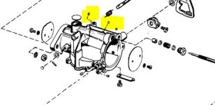

what is... I rebuilt the carburetor thoroughly .....
did you pull the top dime size plug and clean the low speed circuit incl. the VERY narrow side channel that sucks fuel from the lower carb bowl half. the upper half has a very small passage leading fuel to the top chamber wher the point LS needle allows fuel to enter the chamber with 3 small drip holes.
did you install enought packing on the LS sneedle

There's two ways I know of to determine if it's a carburetor problem. First, when its missing, spray a little starter fluid into the carb and see if it picks up. The second one I've never tried, but I've seen it posted here and it seems logical, wave a slightly open, but unlit propane torch in front of the carburetor opening to see if it revs up. If increasing "fuel" makes it run better, then it's a fuel delivery problem. With that carburetor, you have to get a carb kit because you'll have to remove those lead plugs like mentioned above and the kit will contain replacement plugs. What's the compression on that motor by the way?
