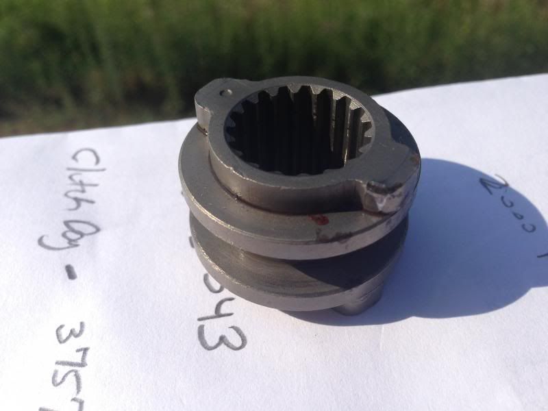

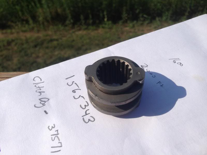

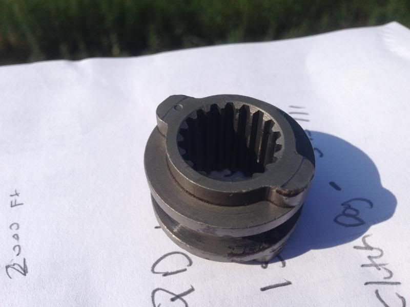

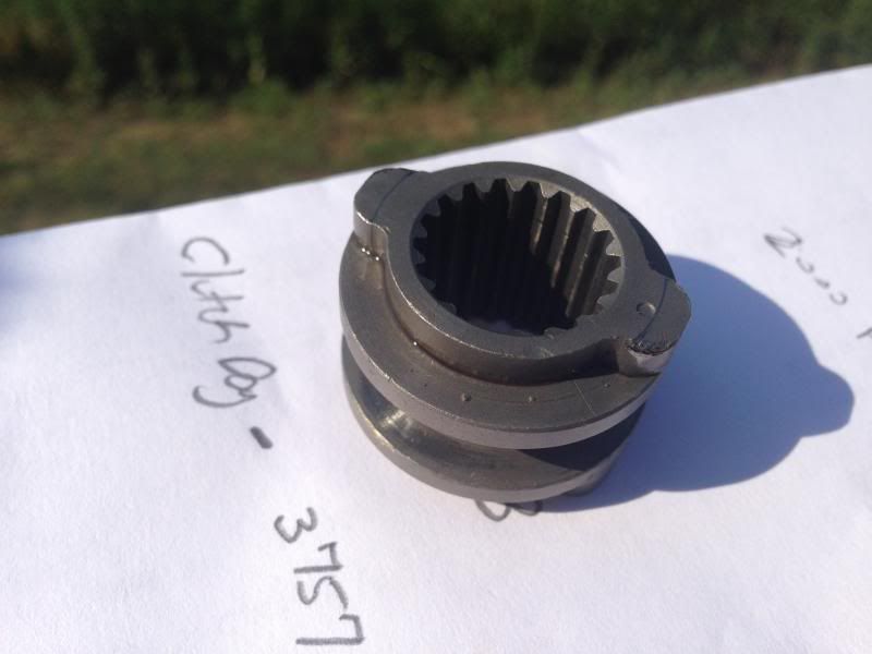

Here is my piece
itsaboattime
Jul 4, 2007
791
Re: 1957 Johnson 10 hp bucking and banging
Yeah that little bit of wear can cause a slip under load. Now those lobes mesh into your forward and reverse gears. I was just wondering is the matching lobes on the gears show signs of wear too.

+1. That's all it takes for them to slip. It's kind of amazing when you think that all of the power for the motor comes down to those two little lobes. Newer motors tend to have clutches with 3 or more dogs to help prevent this sort of thing. Be sure to check the inner mating surfaces of the gears to see if they show any signs of wear. Hopefully, they'll be ok, but if not, you may have to replace them as well. I've had very good luck placing a WTB ad on aomci.org, but you can also check ebay, marineengine.come and other sites.

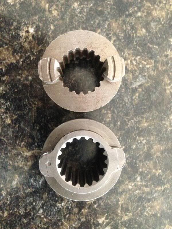

I got the new clutch dog in the mail and of course it's not quite like mine. After putting it next to the gear though I think they are interchangeable. In fact this one seems to grab quite well without the possibility of ever slipping. I'm going to put it all back together tonight and see if I'm right tomorrow.

If the forward gear lobes are worn, have a machine shop square up those lobes, otherwise the worn lobes of the forward gear will destroy the new clutch dog.
Clutch dog - 375711 - $118.30 as of 2010 (Top picture in your dog pics)
Forward gear - 376715 - 377147 - Unavailable since 1982, at that time was $107.25
HOWEVER!..... The clutch dog that you removed (lower picture) is not from a 1957 10hp Johnson lower unit but rather from a 1957 7.5hp Johnson as follows:
7.5hp clutch dog part #376078 --> #333518 - $94.97 as of 2010 and listed as available on 2010
7.5hp forward gear part #376345 --> #377152 - LP $89.00 - Unavailable date not listed.

I'm no expert but I assumed I was the first person ever to enter this gear area. The screws we still perfect with paint covering them. Perhaps someone switched the Lower Units? Were they the same?

The complete lower units are interchangeable between horse powers BUT the inner components differed. It appears that your 10hp model has a 7.5hp lower unit installed. I'm waiting for the other members to join in here one way or the other.
Whenever I replaced a destroyed lower unit to an engine, it was cleaned and repainted professionally so that the engine in its entirety looked like it had never been dismantled. That may be the case with your engine but I can't say for sure without actually being there.
I will look thru my other old manuals to see if any older 10hp model ever incorporated that 7.5hp clutch dog and get back to you.
