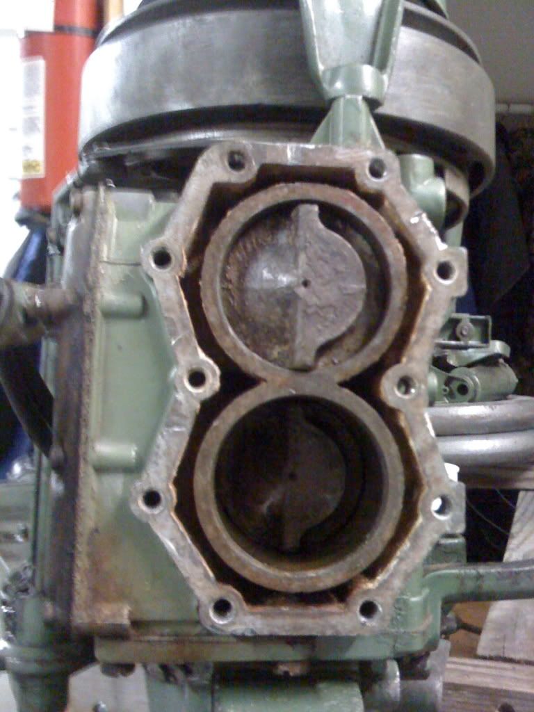

is the discoloration on the exhaust manifold normal ^^^^^^^^^^

It is normal for the paint to burn on the exhaust cover during the first five minutes of starting the motor the first time. There is fire on the backside of that plate and it is only water-cooled along the edge (where it isn't burnt).

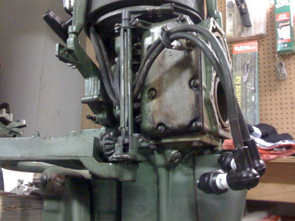

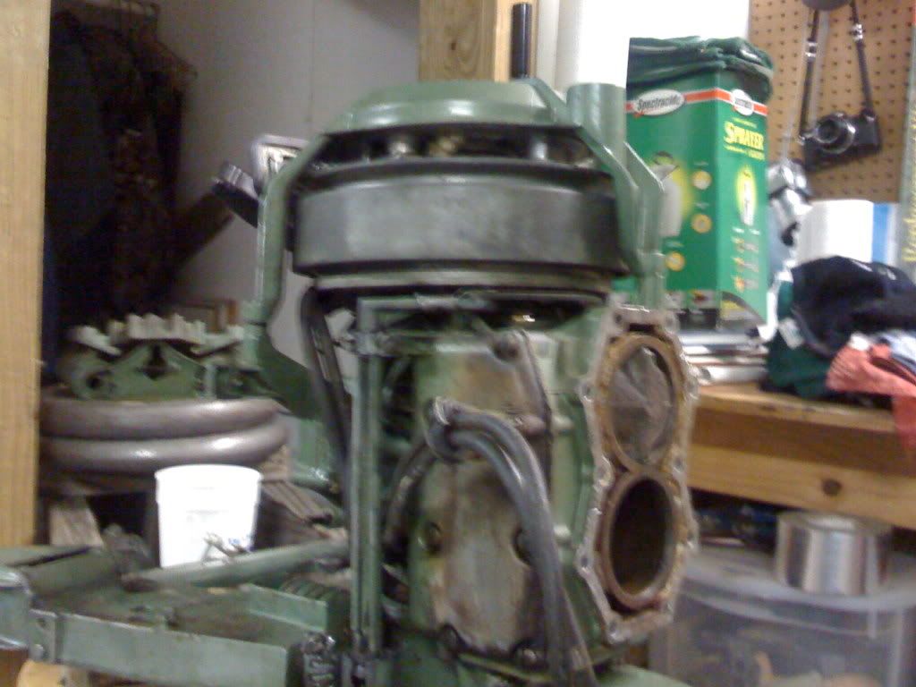

Re: 1957 Johnson 5.5 sea horse Pictures added!!
Good photos. But that's not a '57, it looks like a '54. The 57's were red.

Something is amiss with the year. CD-12 is a 1955, but your cowl decals are to a 1954. Either the model number is actually CD-10 or someone put a 1954 cowl on your motor. For interest sake, what is the serial number?
