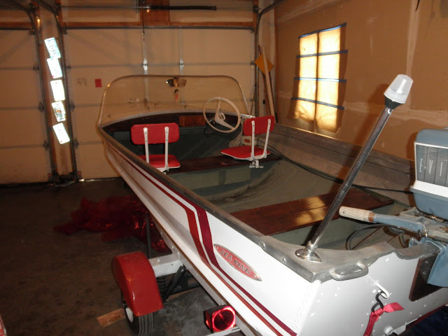

That was a quick. The seat frames were dry this AM. I got the new vinyl sewed and attached to the boards before going to bed last night. I got some new hardware this am to attach with, stainless vs the old std steal rusty stuff.
Here's a picture of the seats mounted in the boat.
Well, thats' about it till spring for this project when we can splash her in. Thanks to all for the comments along the way.
