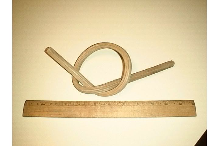

Yea, it's kind of fun to do this to a piece of white oak.
Whoa!!! that's amazing stuff...
It's been a learning journey for sure! I've done woodwork for 30 years and never have done steam bending. Pretty cool process.
