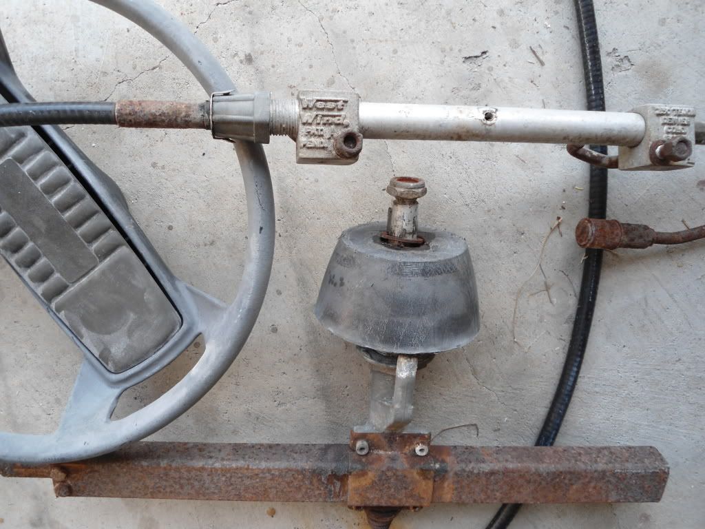

Hey did you ever get your steering worked out ? This is what I have that I probably will never use if ya want it ..
It clamps to the o/b mounting bracket ..
Thanks for the offer Sam!!!
I haven't hooked it up yet but I DID buy a new Rotary Teleflex quick connect system. For the initial splash I hooked up the Cable and pulley system and it's working just fine. Don't plan on doing a lot of High speed turns on the first outing!!!!:D I'll work on installing the new system after that.
