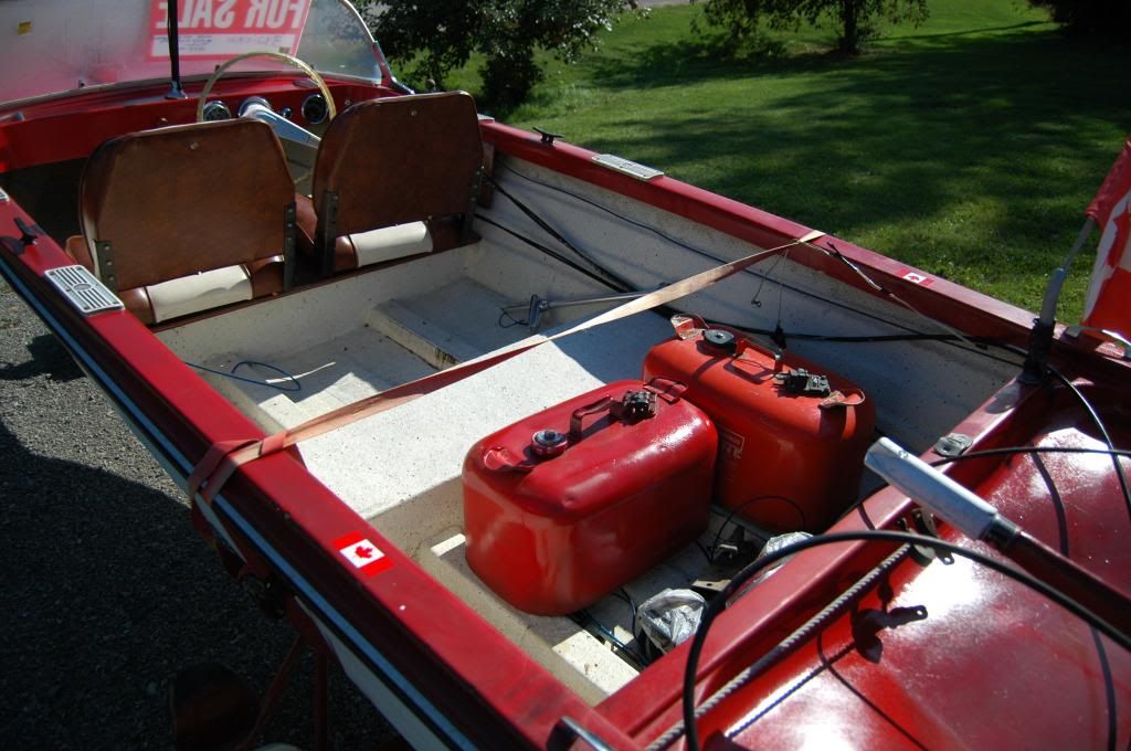

Based on this pix:
There may not be a typical deck w/ stringers etc.......
You can also get a general impression by gauging the overall condition & appearance of the boat, it's interior & exterior, motor & trailer.
From the pix, it seems to be well maintained, not perfect, but also doesn't appear to have anything that would be a red flag that something has been covered up.....
It does look to have been left outside uncovered, from the leaf/brown staining along the keel in the pix I re-posted. Maybe just once :sleeping: oops
But there's no haloing in/on the gelcoat around the chrome fittings & not much (if any) pitting on them. The steering wheel also looks to be in near mint condition. They are very susceptible to UV damage & cracking....
I doubt the seats are original vinyl, but that can just be another thing to bring up. Not really a hammer to help lower the asking price, but can let the seller know that you aren't un-knowledgable about boats & their construction and etc... That w/ what you've learned in your tear down & beginning put back of your boat project..

It looks almost like my Custom Crafts foam support core with the seat supports and all, which is interesting because the steering wheel also looks very close to the wheel on my boat. gold colored resin with gold flake wheel with a nearly identical center.. The side brackets for the windshield is also similar tho they were probably just stock Taylor made items The rest of the boat is totally different..
