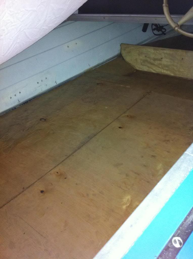

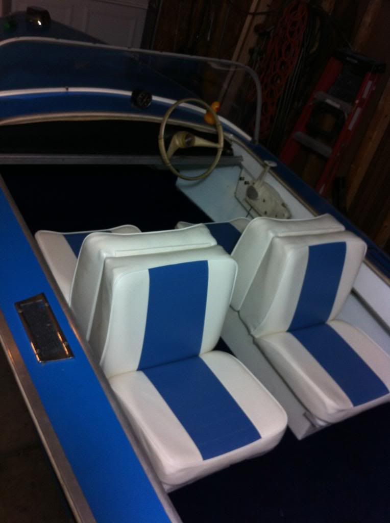

I finished glassing the floor and foot well last night. For the top of the sole I used, 8.5 ounce Twill E-Glass and 435 resin . Carpet goes down tonight. I found a nice Royal Blue by Lancer at Menards.

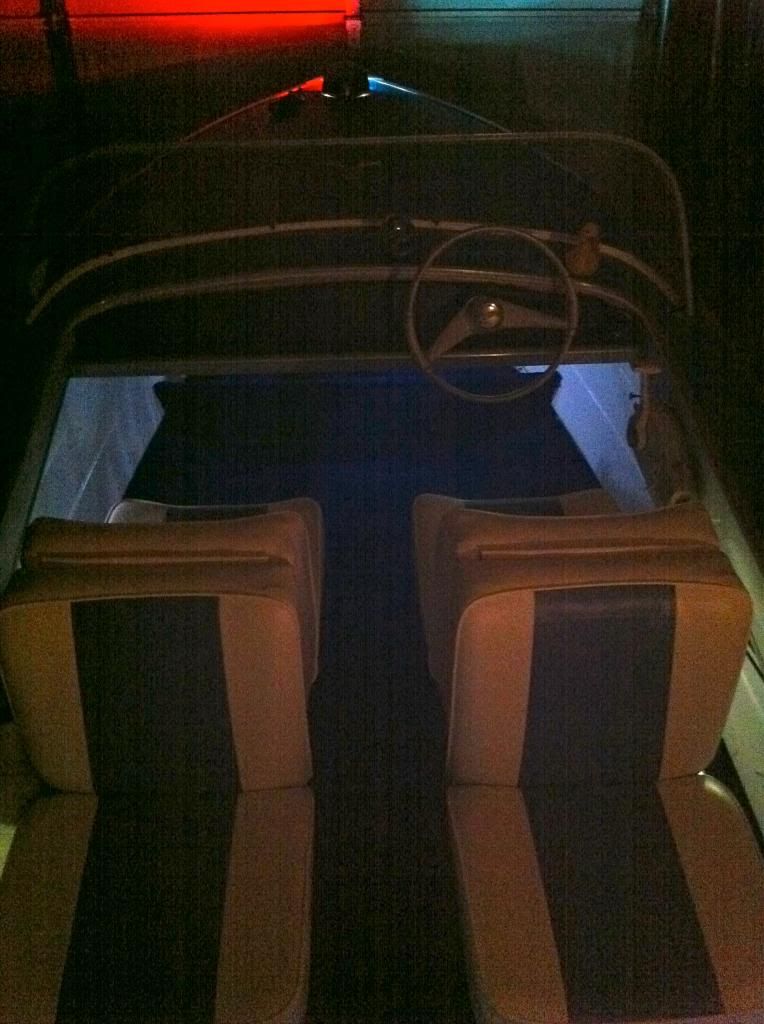

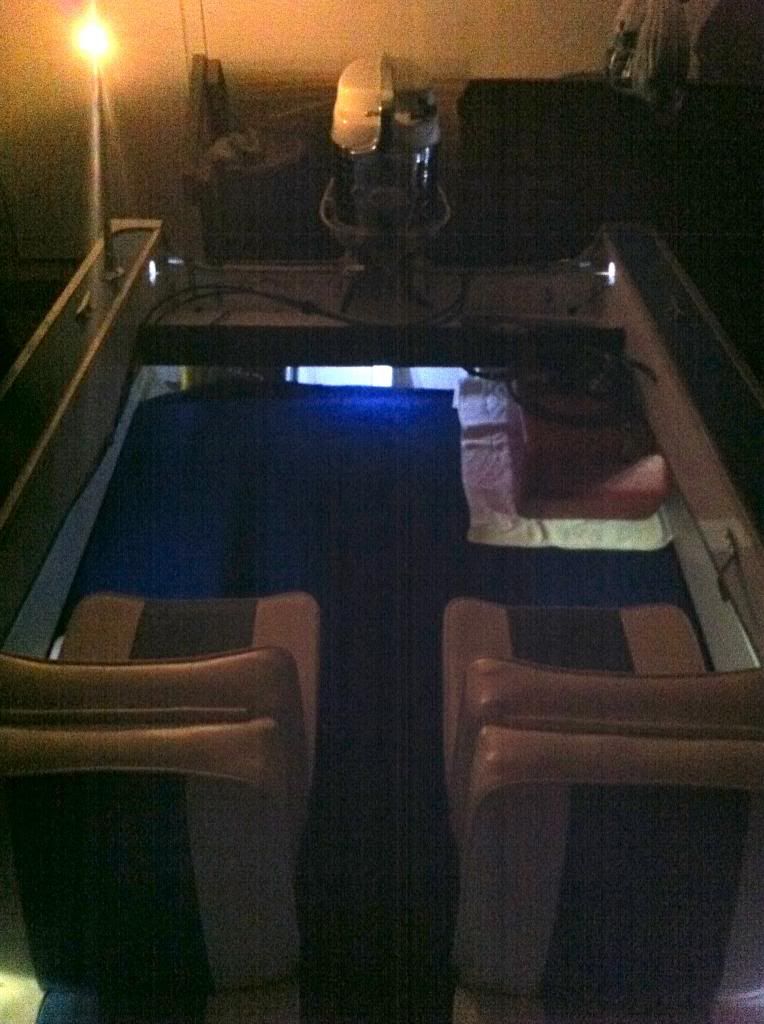

Carpeting is down, old wiring is out and new wiring, with fuse block, is in.
I added LED accent lighting under the gunnels and in the bow. This is on an old school, 2 stage, brass switch. First connection is the bow, second is the gunnels.
Also put the running lights on this type of switch. Now I can have an anchor light on by itself or tandem with the navigation lights.

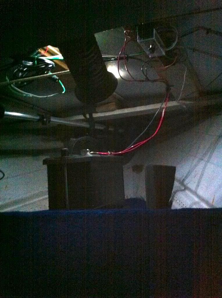

Pic of bow area, looking up from footwell. New Battery holder, fuse block, neutral buss, and emergency propulsion systems (trolling motor hanging from bow supports).

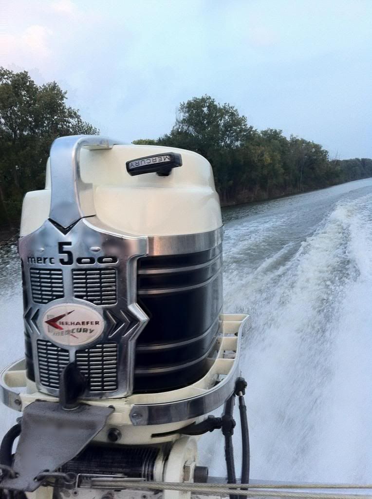

Rebuilt the magneto yesterday with new rotor(magnets) and points. She gained 4mph...

Nice work... ya know that terrific pic of the merc would make a great avatar pic!!!!

She looks good! If you fix the pull start (it's upside down) there's another 2-3 MPH in her. :D:joyous: Did you have to give up any family jewels for the magneto parts? Last time I checked mucho dinero! :eek:

Thank you.
We are going skiing again later in the week to test some additional props....and waste some fuel having fun.
For some reason every time I get in back to take a pic the handle is upside down and I don't notice until I get home....
