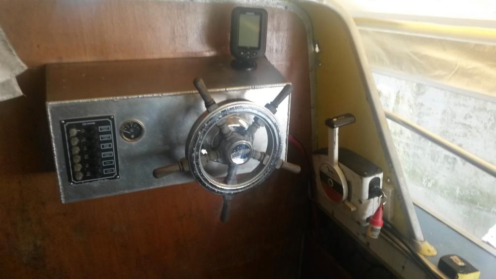

Did you bring the interior up to what she is now? Not too shabby. Don't forget on the water pics, Duke.
BigDukeSix
Dec 13, 2011
11
All I did was paint the interior. The existing wood is real solid. Also sealed up all the hardware for the railings, etc. that were leaking. Still have one small leak at the forward hatch I need to address. My favorite part of the whole boat is that steering wheel. Maiden voyage is today. Will get some pictures.......as long as it stays above water.

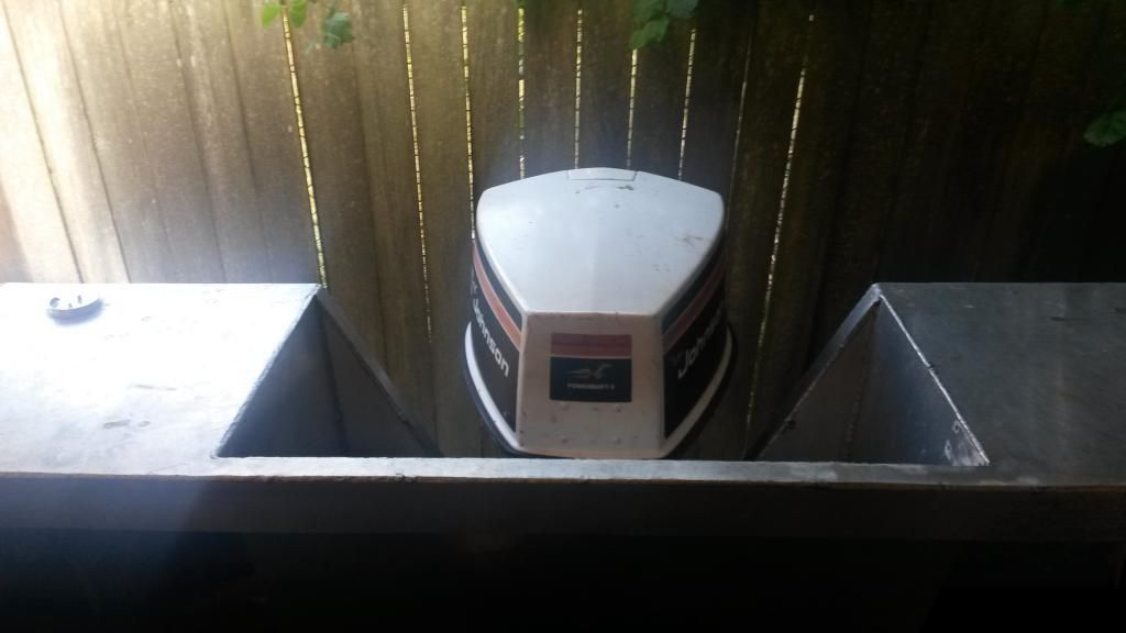

First launch of the old rig was successful. Trailer has some issues that will need attention but is serviceable in the short term. Boat appears to be tough to get up on plane with the Johnson 85 I have on it now. Seems to starve for water at the prop if I accelerate to quickly. Didn't have that problem with this motor on my smaller aluminum. I am thinking it might be an inch or two to high. Not much I can do about that as it is already mounted as low as it can go and trimmed all the way down. All in all I think this boat will be a nice bad weather crabbing vessel and nice weather family boat. I will post on the water pics once I get them.
Watermann
Jan 12, 2013
13,849
Hey a lot worse things have happened on maiden voyages. Check the AV plate above the prop and see how far it is above the bottom of the hull. It should be about even.
