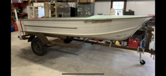

Hello to all. I was given this 1963 Starcraft and it does not have a vin number on it. Looking on the interweb, I think it matches a Starmist, but not too sure (by matching the four foot pads on the sides and the two drain holes by the motor). Any input would be appreciated.
My next question pertains to the floor. I found that foam is required to be installed, but does the floor go front to back in one level or is it cut somewhere below the dash (maybe where the strip of aluminum crossed the center support near the throttle assembly) so that it slopes to the bow slightly? Any photos of how this floor is situated in the boat would be very helpful. As you can see in the photos, there is nothing in it (except mother nature). Also, there appears to be some kind of "foot rest" that might attach to the flooring (can be seen in the second interior photo next to the aluminum strip going left to right by the throttle). Thank you in advance.

I believe I have a Starmist (no vin plate, but pics online lean towards that model). I received the boat with the floor removed. Any help with photos, plans, experience, tips, etc on installing the floor would be greatly appreciated. I'm guessing there was a front half (the seam about where the front seats would be) and the back half. There is an aluminum keel piece (stands verticle going across the rib supports) going from the rear and ending where the front seats would be located. There is also a cross "brace" (piece of aluminum about 1/8" thick, 2 1/4" wide and 4ft long. It attaches on top of the keel piece and runs left and right. Is this where the 2 floor halves/joint sits on? Again, pics would be awesome, and any input appreciated.

So I take it no one has a 1963 Starcraft Starmist (or equivalent) that can share a photo of what their floor looks like so I could get an idea of how it sits in place? Issue is the forward section as to how the floor meshes between/over the floor support braces below the floor.

The deck (floor) runs flat from stern to bow. The bow pieces taper and have scallops along the edges to allow them to sit down further over the ribs, not along the top edge/end like the ones at the stern.
Deck at bow sort of resembles an flint arrowhead....
Look thru any 14, 15 or 16ft closed bow aluminum Starcraft rebuild, the deck fits similarly in them all at the bow.

Had my boat sandblasted, polished the trim, power washed the whole boat to get ready to seal the seams. Floor is the next task. Haven’t had much luck on tips here so it gonna be an experience.

Sealing seams on the inside , use Gluvit or Coatit. Both work well. Replace any rivets that are bad or missing, rebuck others. Have you done a leak test?
