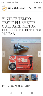

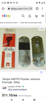

The water inlet is the screen aft of the propeller. The big round hole at the question mark is drain hole for the drive shaft isolation tube.
Muffs do not work on this motor. There was a Tempo Flushette made for it "back when". Lotsa luck finding one now.

Is it either of these?
