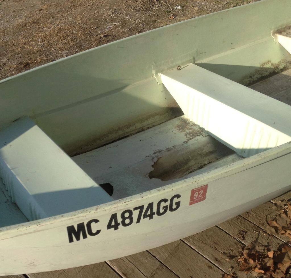

Hey all,
Got a old boat I want to get in ship shape again over the winter. She's seen better days, someone used some gross greenish house paint on the hull and the floors are busted up. I got it legal last season but didn't make it out on the water so now is the time to make it right and make it what I want her to be. So first thing is first, the floors. The are broken out and what's left is brittle as hell, what's the proper way to fix that? The floors appear to be a thin fiberglass. My thought was good plywood, some good sealing primer and some carpet but I'm just unsure on how to handle the remains of the old floor. What's the best plan of attack? I tried uploading a photo of what I got but the photo size is too large and I have no clue how to downsize it on a phone, so if anyone know the truck to that let me know also. Thanks again.

Are those fiberglass tabs holding the seat benches to the deck (floor) or the hull. Does the deck run under the benches? Or is the deck only between the benches?

JB the deck is only between the benches and I think that tab is actually molded into the hull. I really like that idea ondarvr but I wonder about the blocks since they are being drilled into 51 year old fiberglass, I worry about it cracking and blowing out. Like woodonglass I wonder if it would be stable but I like the idea of it being removeable yet theoretically soild. My nephew would be the only kid on that boat in the foreseeable future and he's only three months old, so I got some time to figure out these floors before he needs to learn to fish. She's a strong old girl but I don't want to put too much into her.

No matter how you decide to put the deck back, you'll need to get the old out, and clean up what's left. Post a pix once you get the old out.
From the pix I posted it almost looks like the deck is only covering the semi-vee down the centerline of the boat. Then once that piece is in place, there's a layer of fiberglass across it and the outer sides of the hull. Look at the layer of peeling fiberglass along that semi-vee's edge leading to the bench tab in the top center of the pix I posted. At the tab there's no void below the fiberglass to allow for a deck, and that fiberglass skin looks continuous to me.

If there's wood in the old floor I'd pull it out (hard to tell in the pic), if it's just glass I'd leave it.
The screws can be made to hold without much work.

Did have it out on a pond last year with oars to test her (four guys none of us under 6 foot 200 lbs 200-300 pounds overcapacity) and she performed well and didn't leak a drop. But the floor in question was coming apart the whole time into small peices, I wonder if the excessive weight played apart in it. It is just fiberglass, no wood so I suppose I could leave it, would there be any cons to leaving it there?
ondarvr
Apr 6, 2005
11,527
Leaving it gives a little support for the hull and the new floor, there is no downside.
