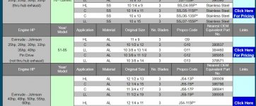

Don't buy a prop for your motor through this website.-----The listing for 40 HP 1960 to 1976 shows totally wrong prop !!!----40 uses same prop as the 28 HP.

The prop that shows up ( picture ) on this website is a through hub exhaust.----Not a pin drive either.-----There is no way you should be putting a 9" diameter prop on this motor.-----Hurry find a boat shop for some old time factual help.

Racerone - not sure that I have a choice...every site I look at for pin drive props of this size only come in 9" diameter size...Screenshot 2021-03-16 103920.jpg
39,766
kdiddle------Please be more thorough in your research.-----The 28 in that 15-28 is a totally different motor than the 28 HP that you have.----Hurry and visit a boat shop for some help.----The internet searches are failing you !
