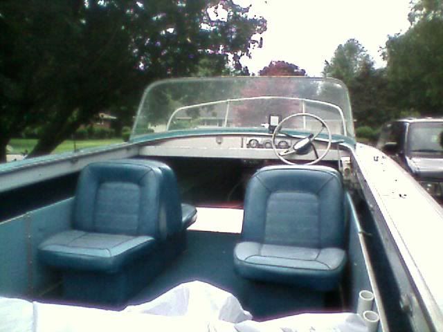

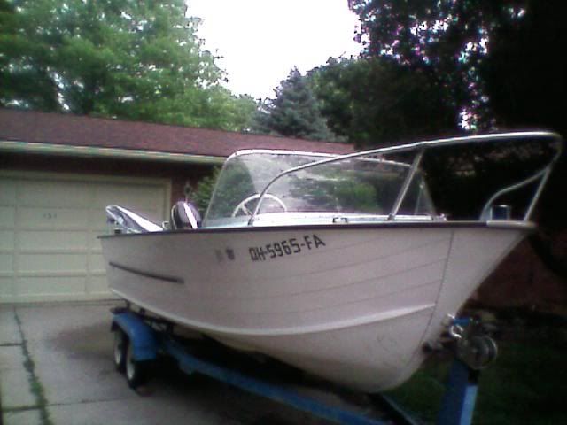

Hello, I'm starting to do some work on the old boat so i thought i would document it here. I've had it now for about 6 months and used it all summer. But, the floor,transom are showing some rot so I'm going to fix her up. I'm going to put in some new seats,carpet and side panels. I may do something with the dashboard also. Here it is when i first got her home.

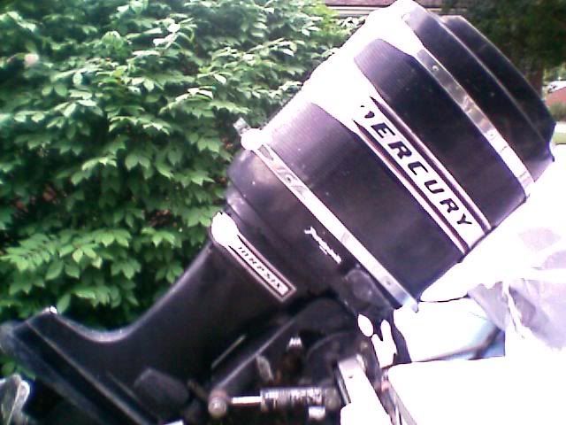

Here's a pic of the motor. It's a 1967 mercury 1100 ss

Here is how it sits a little earlier this evening.
I took the controls off after I took the pics. Tomorrow I am going to take it to a shop to have the motor taken off and have a professional take a look at it. It seems to be leaking gas and I don't know outboards at all.

I would guess that one of your carb floats is stuck causing the gas leak. Might as well have the carbs gone through, do the file pumps and replace the fuel lines.
Good looking boat you got there!
