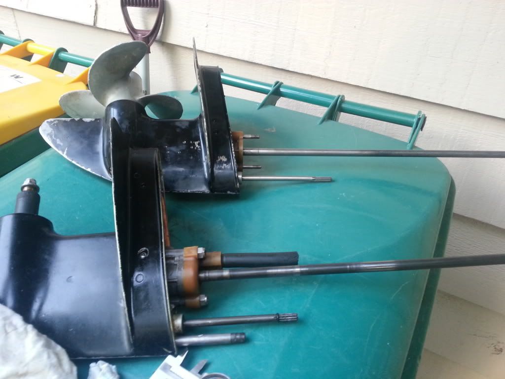

Bought this nice little merc knowing of the problem. The original prop was spun. Came with a later 8 spline LU that doesn't fit. Guy I bought from bought the later model LU and tried to put it on. Didn't fit, got frustrated and bought a new 4 stroke out board.
The shifter shaft seems to be the problem. It is longer by half an inch.
So do I look for a 6 spline prop? Try to redneck engineer a fix for the original prop? Try to figure out how to fit the newer LU to the older Motor?
Motor is good. 120psi both cylinders. Starts easy and runs well.
Newer shift shaft.
Original shift shaft.
Both sitting on trash container. (seemed comical)
