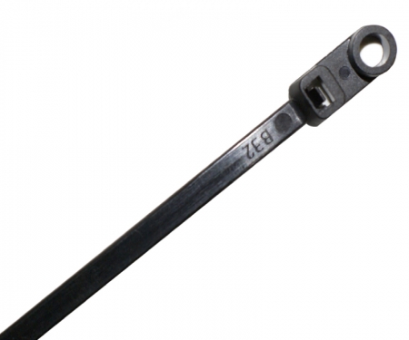

I have to revisit wire management along my Gunnel. I installed a temporary fix so I could get out on the water, but now my fix is in the way of re-installing some rod holders that I will be needing. I like the hangers that I've seen in other rebuilds, but I am going to keep it easy and stick to as original as I can on this one. Originally my boat had vinyl straps that fastened to the bolt ends, of the bolts that hold on my rub rail. I am going to go with that idea and order some of these eye mount zipties:
Black mounted head cable, zip tie - Black mounted head cable, zip tie
I was excited to find these and It seems too easy, not to give them a try for this application...

I started with nylon replacements, but could only find 1" diameter which wasn't enough.
https://www.amazon.com/gp/product/B01MXELE9Z/ref=ppx_yo_dt_b_asin_title_o09_s00?ie=UTF8&psc=1
These ties that I ordered are 14" ties, 120lb strength, UV protected, and the pack was like $15 plus shipping. 100 in a pack. I'm not sure what size hole the screw fits. I kind of like the disposable feature to them. I can cut them off, do what I need to do and then slap another one on. A pack of 100 ought to be enough. I was considering the cushioned stainless things, but I wasn't sure if I could find them big enough. In addition to my steering and throttle cables I've got battery cable running down the side of my boat.

I ended up with 1.75” clamps, which was overkill, but they are available in other sizes also. I also have 8ga. cables run to the front for aux devices and 1.5” probably would have been fine. The nylon clamps I found originally were also not big enough to fit over the studs, so hopefully the cable ties have a larger diameter hole. I like the tie wraps you found too- will be interesting to see how they work in the harder to reach areas.

The zipties ended up working great. The length (14") are a little long, for sure, but they are thick and tough.
