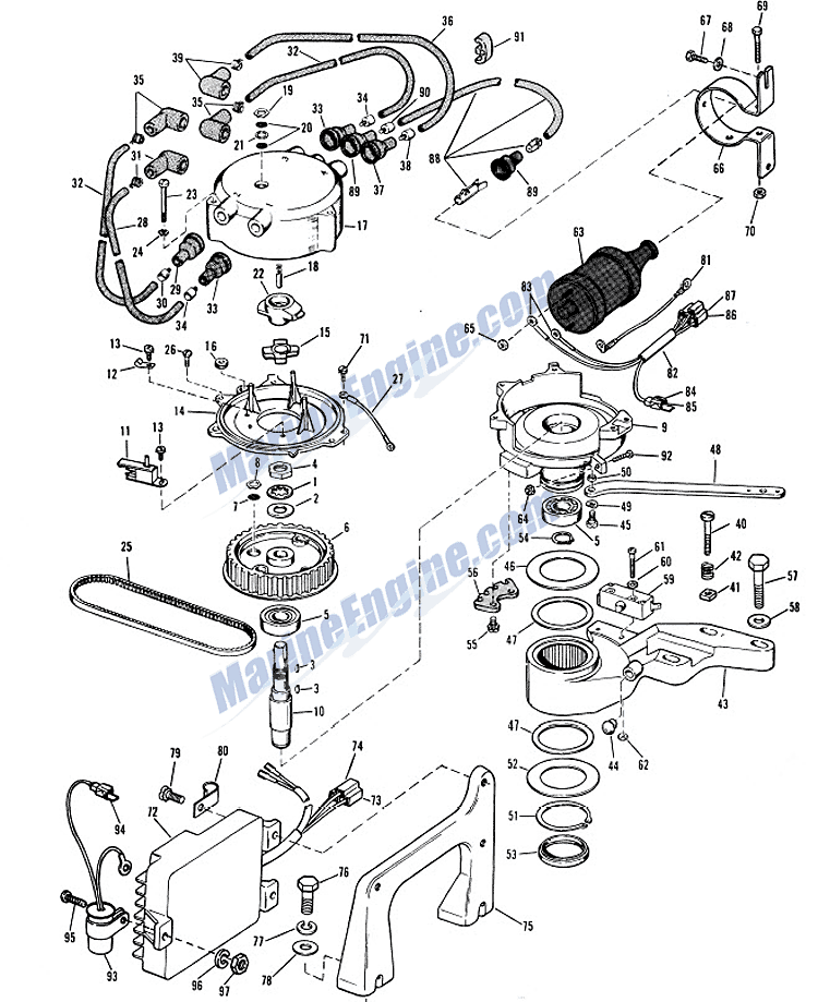

Considering picking up what appears to be a Thunderbird Iroquois (need to go see to be sure) with a 1967 100HP Johnson motor. Seller swears it needs a pulse pack... I think I'd be doing some diagnostics myself to be sure before I start throwing money at it, but it sounds like it's changed hands a couple times without being touched so info is going to be hard to come by. Would this be the correct manual for it?

Battery Capacitance Discharge Coils - Continunity Test)
(Joe Reeves)
Remove the primary wire the screw type terminal. Remove the coil and unscrew the HT wire from the distributor cap.
Connect the black lead of a ohm meter to the HT wire, then with the red ohm meter lead, touch the ground wire of the coil.
Then touch (still with the red lead) the wire that normally attaches to the powerpack output lead. You should get a reading on both touches (contacts). If not, check the HT wire by unscrewing it from the coil. After removing the wire, the check can be repeated using the internal threaded prong within the coil instead of the HT wire. Poor or no continuity of a coil is one reason for erratic or no ignition and/or s/plug fouling.
(Battery Capacitance Dischage Powerpack Test)
Various OMC Engines
(J. Reeves)
Purchase a small 12v bulb at your local automotive parts store (the 12v bulb is to look like a flashlight bulb, not a headlight bulb). Solder two wires to that bulb, one to the side of the bulb (ground), and the other to the positive point. You might use a bulb of a somewhat lower voltage to obtain a brighter glow... just a suggestion.
Remove the spark plugs. With the key in the on position, make sure that you have 12v going to the pack at the terminal block (purple wire). Now, connect the ground wire from the bulb to any powerhead ground. Connect the wire from the positive point of that bulb to the powerpack wire that is connected to the coil wire on the terminal board (blue wire).
Crank the engine and observe that bulb closely (CLOSELY!). If that bulb glows even the slightest bit, the powerpack is okay. It may be a very dim glow... just so it glows! If it doesn't glow, the pack has failed.
Keep in mind, that type powerpack (Battery Capacitance Discharge) demands a top notch battery of at least 70 amp hours. Any less will, in time, cause powerpack failure.

HIGH FIVE Thanks, Joe. That test is exactly what I was hoping to find!

IMHO. I'd stay away from it as that was the first year of battery CD and if you do find parts for it they can get expensive. I've taken a lot of them and converted the ignition to the 1966 model yr which had breaker points and condensers. Much eaiser and cheaper to work on.

Dave... What Boobie has to say holds a lot of weight (conversion) but I understand where you're coming from (restore to original).
Yes the transformer would be the coil in this case. Hopefully that's okay as the going price (if one is found) is outrageous.
Check the transformer on a dark night. Stand in back of the engine (hood off) and have someone crank the engine over. If there are microscopic cracks in it, you'll see a regular fireworks show.... sparks flying all over the place.

Point taken. If it turns out a previous owner is correct and it needs most of the ignition system replaced, I guess it's as good or better an option to swap it out for (I'm hoping) less money, more work?

mtangler, I just followed the instructions above, and found the pack to be bad, and replaced the coil also. Then, when I was putting it back together I found that maybe the sensor in the distributor was set too far from the rotor, and also the lead from the coil to the distributor had no tip, just bare wire. So, I fixed both of those things while I was putting it together, and now it's got spark. On to the carb problems.
