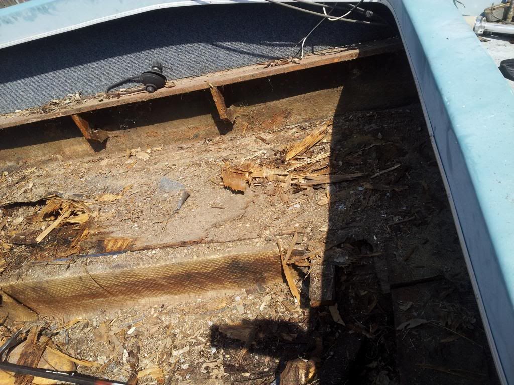

I recently purchased this boat from a guy knowing it needed lots of work. before can include pictures i need to setup a photobucket account . i will get the acount open and post pictures. Love the iboats forum. i wouldn't have even attempted this restoration with out it. Currently we have ripped out the rotten deck and are in the process of removing foam which realy sucks.

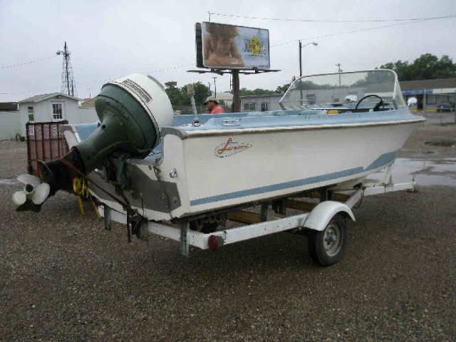

And this is a pic of......?????

The Pic in post #4 was a poorly taken photo of day one demo. Everthing was rottten and foam filled. Currently she has been stripped down and in the final stages of being prepped for transome and stringers. Hope to get more pics up next weekend. I am kind of concerned with the transome someone had a bad day on the water. i haven't uploaded all my pics to photobucket yet so i cant show you.. There was a stainless steel pieces of metal across the transome machined very well i might add that covered the transome where the motor was forced partialy through the hull at the lower portion of the outboard motor mount. i'll see if i cant find the pics and post them soon. My current plan is to attach my transome on the outside of the hull with some all thread then grind down the damage on the inside and lay new glass. when cured ill have to go to the outside sand down and fill in a depression where the damage was and apply some fresh gelcoat to it?

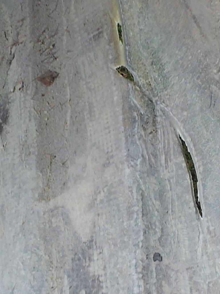

all the deck and foam are out. just one accident:
Someone got carried away with the grinder.
Help and advice will be greatly appreciated...
above is a picture of the transome i refered to in earlier post
and below is a pic of all the grinding done for now ready to lay in stringers
Lots more to come later...

You have your PB album set to PRIVATE. Put some packing tape over the outside of the cuts in the hull then lay in a layer of 1.5 CSM, a Layer of 1708, another Layer of CSM and one more of 1708 and you're good on the inside. Outside will require some sanding and a couple of layers of CSM some more sanding and fairing and gelcoat and you'll never know it happened.
