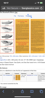

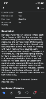

I just purchased this little beauty & I have lots of questions! Not sure if this is the correct place to post though.
