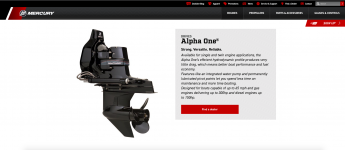

i checked the merk outdrive specs. , and kiekhaefer mercury says yes for diesel application on the alpha gen 2 outdrive

here is where i found the spec for an alpha gen 2 outdrive beeing able to handle diesel engines up to 150 HP and its a mercury site attached below
