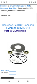

Tough one. Not sure if this helps but this claims to fit that gearcase.

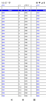

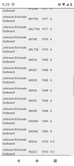

Here is something odd and I'm not sure it even helps. When I plug in 6802 in the where I buy parts, just like you it comes up 1967. But when I go to leroysrambilings his chart has it as a 1968. I think that guess of the 67 to 68 has to be the one but then who knows. Another thing, if you click on the parts in the kit it shows you what it looks like so you might have to just verify that way.
