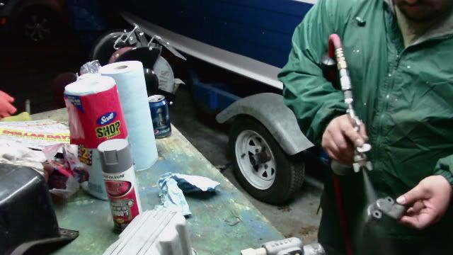

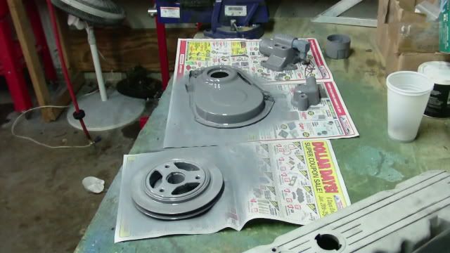

This is for Proshada..
Got me some 2000F primer to paint my pretty engine blue. Prepared my parts by cleaning them with mineral spirits.
and sprayed them with the rustoleum high heat primer.
Here you go you pic freaks. Stay tuned for more pics.

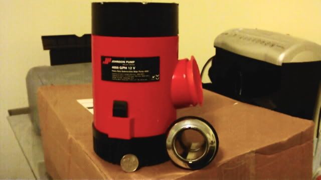

Since we are on the topic on tools I have decided to get a big bilge pump. Looked on ebay and found a Johnson 4000. Gentlemen that 4000 is for gallons per minute!!!! Mates,, I dont want to drown. Im making sure that when if there is a leak I can at least make it to the sore. Got it today and.....well this thing is HUGE.!!
Thats a quarter in front.
Just look at how bigg the thru hull fitting is.
Yeeeeaaaaah, Im gonna have to post a video once I intall it.

Good grief. For a boat the size of yours that is huge. :eek: Did it come with that thru hull fitting? I'd be filling a bucket and hooking up a battery just to see that thing work.
djpeters
Jun 9, 2010
1,824
Re: 1968 Holiday Restoration w/pics
That's not a bilge pump, it's a sump pump....that's bigger than the one in my basement! LOL
