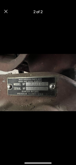

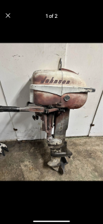

Since the 1955 fell through I found a 1956 15 hp to pick up. He said the glass bowl is broke. I know nothing about it. Be fun to learn on
