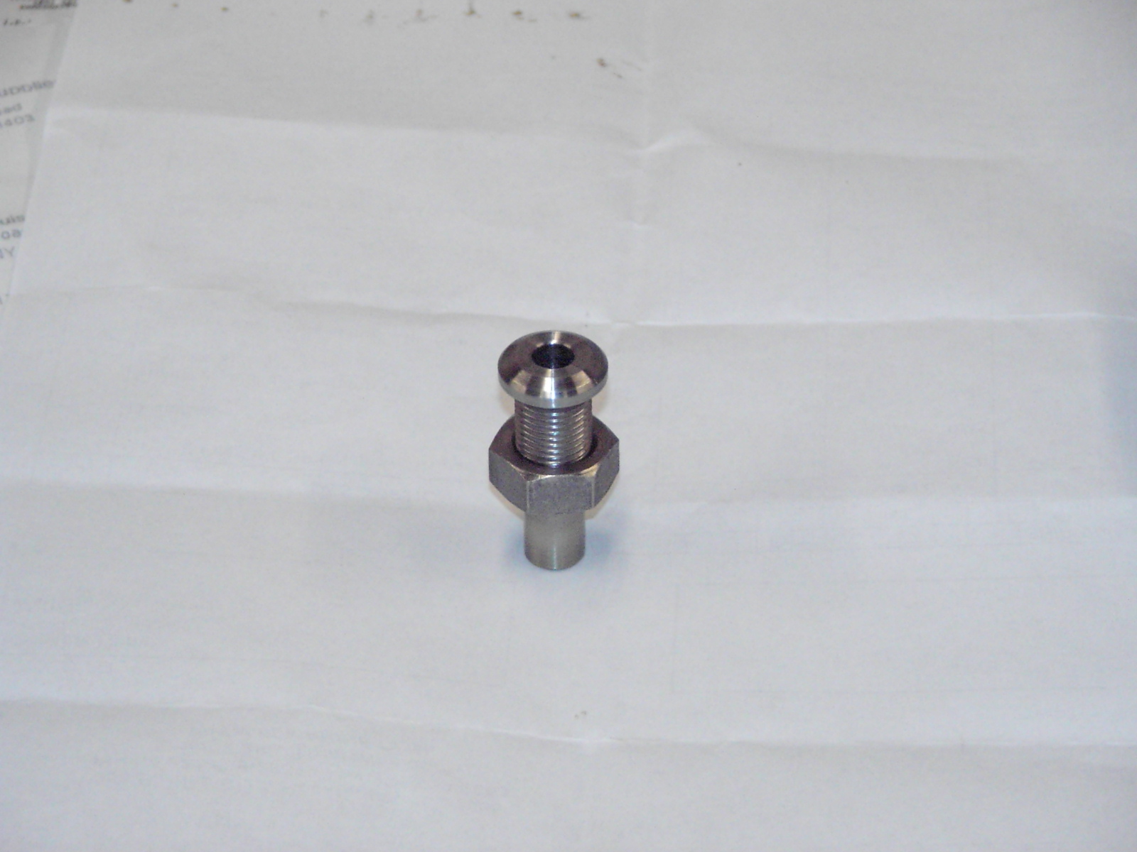

To get to the tansom, the wide splashwell had to be cut away. So lots of surface repair there. The old bilge pump had a long ungly hose hanging out the back of the boat. When I put in a new pump, can I just put a hose fitting on the splashwell and (if necesary) pump water onto the splashwell and let it drain out that drain? I see two advantages to this proposal: 1] no ugly hose hanging over the transom, 2] it will be rreal evident if the pump is moving water as it will be flowing onto the splashwell.

No reason not to, or you could drill a hole in the transom and affix a fitting to it and attach the hose to it so it would go straight out the back or side of the boat. Not need to go to the splashwell and then out, why not go straight out.

on mine it has a fixture in the side that squirts water down the side of the boat, it was clogged up and the PO had just run the hose into the splashwell, worked for him, i cleared the clog and have it hooked back up to the side discharge fixture

Thanks for the ideas. Even though ejecting water directly through the hull seems clean and efficient, it bothers me to drill holes in the transom. Isn't that the cause of all the rotted wood? So I'm hoping to have only 4 bolt holes for the engine mount, and then the smaller holes for the stern eyes.
Speaking of holes in the transom, I'll have to do some more review on how to ensure that the few I do have will remain waterproof far into the future. Same for the drain hole at the bottom which I assume will be a bronze or ss tube. --Peter

When my transom was redone, they taped over and holes in the transom and installed the new one. When finished they re-drilled all needed holes and mounted a stainless tube(best I can remember) with a flaring tool and generous amounts of 5200. Unnecessary holes were lowered below the surface with a die grinder and filled with gel coat and then sanded and polished.
Were it mine I would buy a quality fitting and vent the bilge out the side just below the rub rail. Just my two cents.
