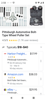

Still have plans to remove flywheel to inspect later today or tomorrow. Today is my sons birthday party, so getting to harbor freight hasn’t been viable this morning
