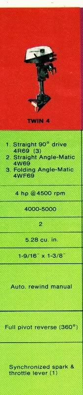

You have one of these three motors.

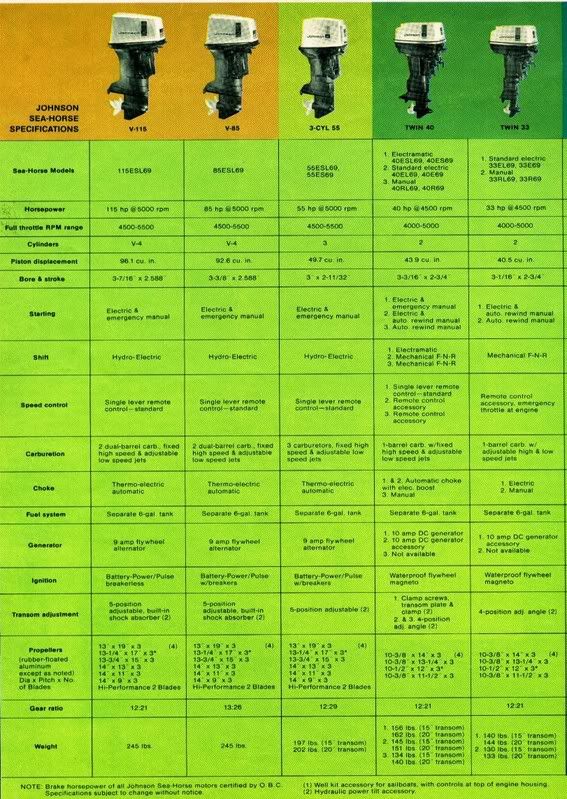

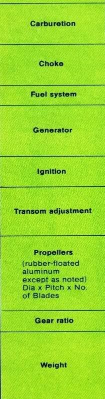

This is scaned from the 1969 Johnson catalog.
Top of page.
Middle of page.
Bottom of page.
I'll scan and post more later.

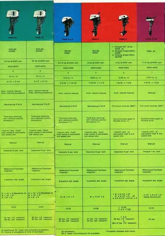

I'll scan and post the motor specifications next.

The 1969 Johnson specifications.
This is all there is for your motor in the '69 catalog.
