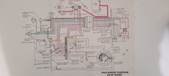

!969 85hp Starflite/ model 85993. I was out briefly on the water and volt meter indicted 13.5 to 14volts but the jumped to 16.5+volts. Idled back to the pier and out of the water.
I had previously replaced the rectifier with a nos part due to the wire insulation falling off.
What actually controls the voltage output on this motor? I don't see anything labeled as a voltage regulator in the wiring diagram.
Also whats the best spark plug for this motor? service manual says L-19V champion

Some motors DO NOT have any charging voltage regulator. The battery keeps getting higher any time the motor is above a very fast idle. My Evinrude. I put in a simple switch to open the POSITIVE output lead of the rectifier. I am a very good electrical person.

Why in the heck would Evinrude design it like that? Especially when they must of know a high voltage like that isn't good for the CDI box.

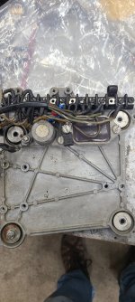

I have read other threads on this site and others about a voltage regulator marketed by BRP in the past. I attached a picture that i believe is that regulator on some parts from a 1970 85hp. My understanding is that it is used in conjunction with the existing rectifier. Also it looks like CDI electronics offer a rectifier/regulator for this engine also.
I would never put a cheap Chinese part on my Evinrude!

That little rectangular box is the " clipper " unit.
Thanks! I was hoping that was the p/n 173640 voltage regulator.
Any problem with installing the 173640 regulator or the CDI 193-3408 regulator?

Check ...WHERE ...you will have a Aluminum space that is FLAT ENOUGH to mount the Clipper to. You CAN NOT just drill holes anywhere you want to !!!! You may drill into water or air tubes. Not a good thing to do.

It is not called a voltage regulator.----Your factory manual would explain what it's function is.
it not shown in my 1969 manual, the part is off a 1970 85hp but also not shown in the 1970 wiring diagrams
The rectifier (diode bridge) converts the AC output of the stator to a (mostly) DC voltage.
The regulator simply takes the rectified output, now DC voltage, and regulates the output typically between 13.5 and 14.2 volts.
The "excess" voltage is dissipated by the regulator as heat. Proper heat sinking of the regulator is critical for the unit's long term survival. You could use just about any voltage regulator you want as long as its capable of handling the rated output (amps) of the circuit.
