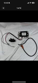

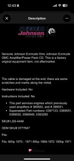

I dont know if a electronic repair person can fix as its in epoxy. I asked around. Although meantime i found this replacement the description claims it works for my year but i do not see the white and black wire plug in on the replacement part.
