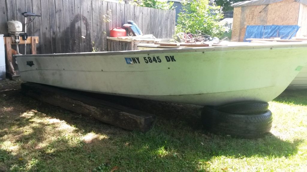

this is my alpex 14 ft I got the rtansom and seat brackets removed atm next will be to cut the old floor out and insert the new stringers.

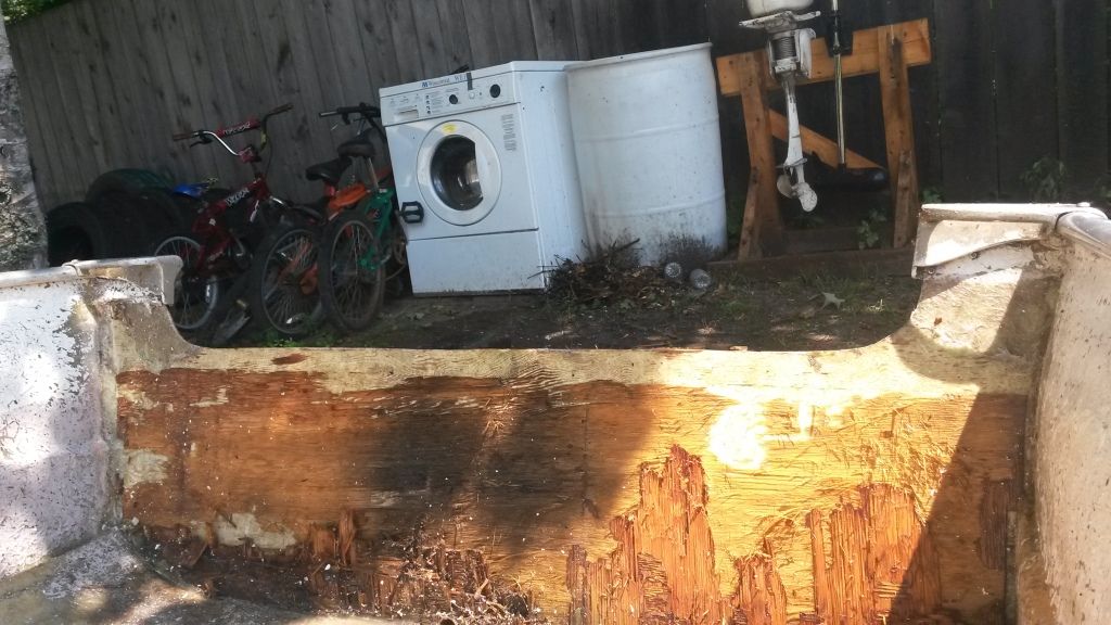

​finally got the picture issue worked out. here's a picture of the transom I'm working on as u can see I got the majority of the old wood removed and working on slowly chiseling away at the remaining flakes that are attached to the old fiberglass by epoxy

Are you sure its epoxy?
Alpex liky used polyester resin, unless a previous owner redid the transom

idk what type they used all ik is the previous owner replaced it with a really shisty looking job it wasn't sealed and got filled with water. he had also build homemade storage boxes attached to the transom that I cut out for being water logged as well. the side supports were rotten inside to pulp and I'm sure the stringers are as well bc when I stand in the boat the floor kinda gives and the stringers cant be too big. theres only aprox 3 inches between the floor inside and the outside hull.
