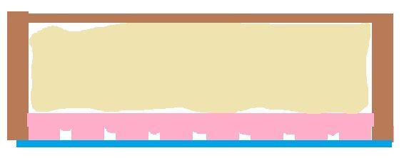

Any ideas on how to keep drains open (drain the boat hull from bow to stern along stringers), yet use pourable foam? I was thinking of a pvc against the stringer with holes drilled in it. The holes would face the area where the stringer meets the hull (the angle) so it wouldn't fill with foam. Then if water, or more like when water gets in it could still drain through the limber holes in the rear, right into the live bait well or ikima (what its called in Hawaii). I would close the holes off with garboard drains or brass tubes with drain plugs. I tried looking for a solution but really haven't found one. I guess if I just foamed it too and made sure that the limber holes were open, the water would flow to the back also when the hull is raised.
Woodonglass
Dec 29, 2009
25,929
Uhmmm, this has been discussed Ad Infinitum here on the forum. LOTS of different methods have been devised but none to my knowledge have been done with a great deal of success. I've never posted this but here's what I've been thinking of so take it for what its worth. If you used a piece of 1/2" slap foam and cut 1" strips and laid them down on the hull and then laid a sheet of the slab foam on top of them they would form channels under the sheet. You could then pour your foam on top of the slab foam. The pressure exerted during the expansion of the foam might be enuf to push the slab foam down into the channels but I don't think it would push it down all the way and there would be enuf space left that if water did get into the hull it could drain back to the transom/bilge and be removed. Anywho that's my "BrainStorm" on the issue. If you do a search, you'll prolly find a plethera of others. But I'm a firm believer that with good care and maintenance a properly installed and sealed deck should not allow water to penetrate below the deck and only a catastrophic event should be or worry and you will have other issues to deal with in that event so drainage should not be a worry.
This "Bad" drawing might illustrate what I'm trying to say. This shows the deck, two stringers the yellow pour in foam, pink slab foam and the cut strips making the channels with the blue hull below. Hopefully you get the idea.

Uhmmm, this has been discussed Ad Infinitum here on the forum. LOTS of different methods have been devised but none to my knowledge have been done with a great deal of success. I've never posted this but here's what I've been thinking of so take it for what its worth. If you used a piece of 1/2" slap foam and cut 1" strips and laid them down on the hull and then laid a sheet of the slab foam on top of them they would form channels under the sheet. You could then pour your foam on top of the slab foam. The pressure exerted during the expansion of the foam might be enuf to push the slab foam down into the channels but I don't think it would push it down all the way and there would be enuf space left that if water did get into the hull it could drain back to the transom/bilge and be removed. Anywho that's my "BrainStorm" on the issue. If you do a search, you'll prolly find a plethera of others. But I'm a firm believer that with good care and maintenance a properly installed and sealed deck should not allow water to penetrate below the deck and only a catastrophic event should be or worry and you will have other issues to deal with in that event so drainage should not be a worry. This "Bad" drawing might illustrate what I'm trying to say. This shows the deck, two stringers the yellow pour in foam, pink slab foam and the cut strips making the channels with the blue hull below. Hopefully you get the idea.
Wog...Hmm once again you have as usual "IMPRESSED ME" I have been didiling along that concept forawhile. I was gonna put the pink foam on an angle against the stringer making a channel and some around the limber holes. Then use the pour in foam. In Spainish your title phonetically would be pronounced "Henio" spelled wrong. {means genious}.
Kripes being a plumber sometimes we plug pipes that weren't stopping water so we couldn't solder to repair {in the old days} with bread or jelly beans. Then when the water came back on they dissolved. I was thinking of laying some loaves of bread or pcs. in the channel then por the foam and wet it out gradually.
I like your idea.
Kin there is another practice of "bagging the pour" . So what you do is por the foam into a good trash bag laid in the are you want, partially fill it then when dry you can lift it out hence it does not actually obstruct the channel, then you can make another pour over that thru the deck. Like the man said there are alot of discussions and positions related to the foam topic.

Wog...Hmm once again you have as usual "IMPRESSED ME" I have been didiling along that concept forawhile. I was gonna put the pink foam on an angle against the stringer making a channel and some around the limber holes. Then use the pour in foam. In Spainish your title phonetically would be pronounced "Henio" spelled wrong. {means genious**.
Kripes being a plumber sometimes we plug pipes that weren't stopping water so we couldn't solder to repair {in the old days** with bread or jelly beans. Then when the water came back on they dissolved. I was thinking of laying some loaves of bread or pcs. in the channel then por the foam and wet it out gradually.
I like your idea.
Thanks guys. Ive read a lot of the foam topics, but none seemed like the right solution. Both of you have put good examples, I guess I'll cross that bridge when I get there. Went to Walmart, got the box fan, went back to HD to get the AC filter since Walmart didn't have any. Also picked up some 1/2"x7" bolts, nuts, washers for the transom clamp. Also got the deck screws, went with 1 5/8", figured I could use those to tie the deck in also and then PB the holes like the transom. They'll probably stick through a little on the transom glue. Is it better to go with the 1 1/4", figured the 1 5/8" would grab more?
kinaiahi61 It is my opinion that every compartment, below the water line, containing poured in foam should be sealed. I wrestled with the same issue, and at the end of the day if there are drains under the foam those drains are also direct entry points for water. Just a Thought!!! Nice Boat!!! :thumb:
Also if you have a hull penetration and you have provided drians back to the bilge and the bilge pump can't keep up you may sink. if you have foamed and sealed compartments and have a hull penetration you shouldn't sink.

I see the point of sealing up the cavities. However it seems like water gets into everything. What about condensation? Just seems like moisture is going to get in no matter what and it would be nice to be able to drain it out. Aaaggghhhhh. Decisions, decisions. Keeps me up at night😫
kinaiahi61
Nov 10, 2012
215
I am probably just wayyyyy overthinking this. I should just seal it all up, makes sense!!!
