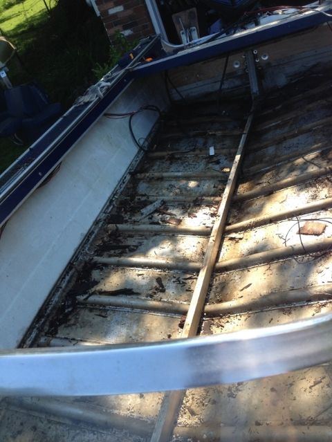

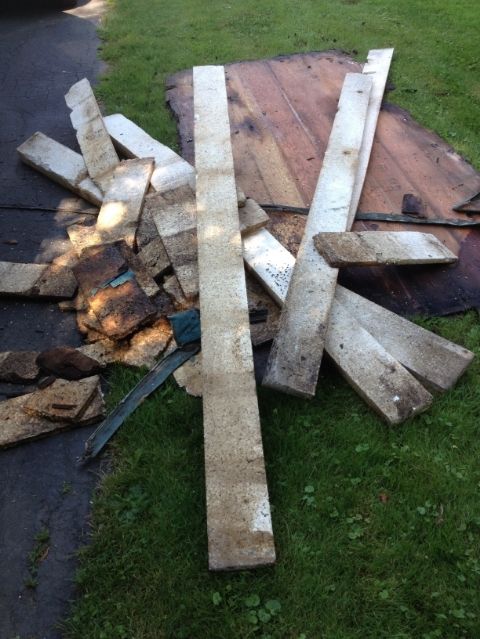

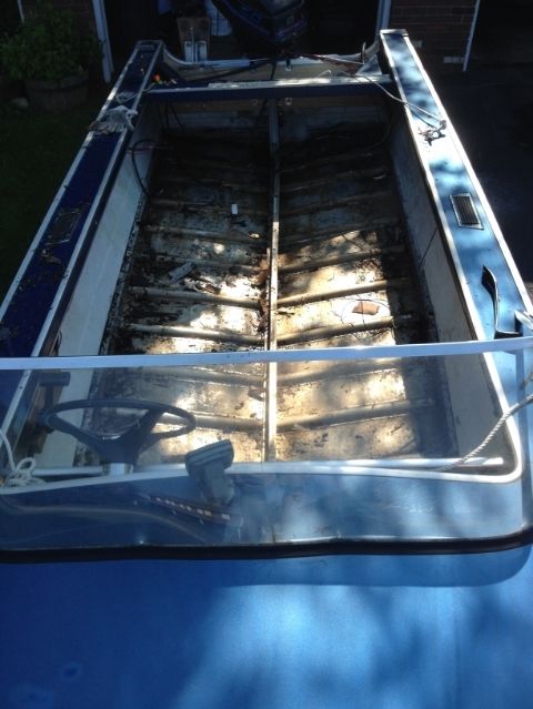

Back at it again. All of a sudden the floor just fell off the boat. More to come....

Yeah that falling out with the deck sure can be a PITA :rolleyes:

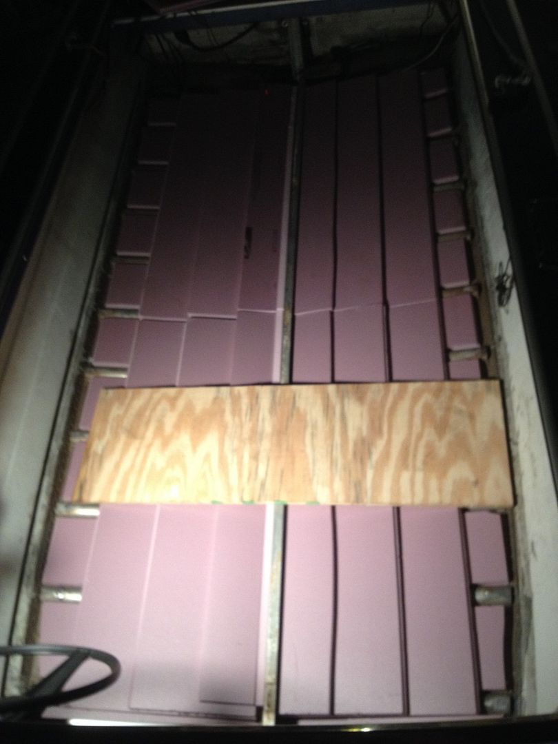

Foam going in
All there. It was not s bad as I thought it would be. The 1" cut clean with a utility knife and snapped right off. I was fearing a mess of pink bits everywhere.
5/8 inch floor going in next (sorry, 19/32 for those keeping track). Feels mighty solid compared to 1/2 inch half rotten floor that came out.

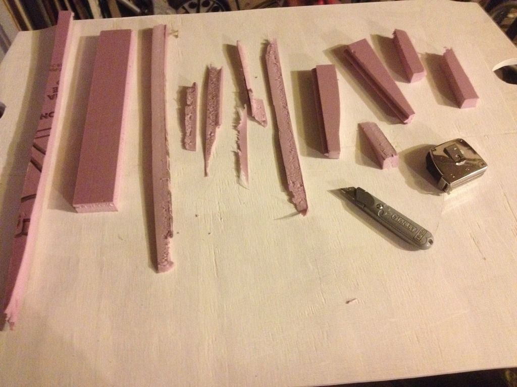

So I used 3 sheets of 1" foam for 8 cubic ft total. Gives ~480 lbs floatation. Plus a couple cu ft of wood and math-math-math hopefully it is enough. As much or more than it came with anyway.
After 3 sheets, here are the leftovers:

Nice usage.
You might want to throw those scraps in for good measure. :rolleyes:

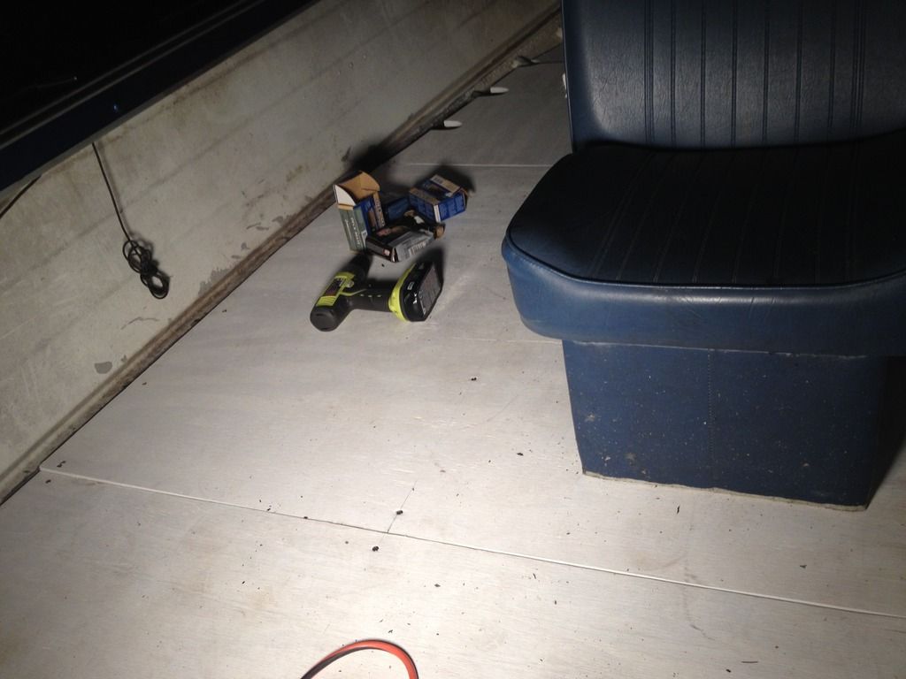

Starting to resemble a boat again. The floor is quite solid. I may have pushed it a bit on the foam... The floor went in pretty tight as it had to get drawn down to the stringers. Perhaps I was counting on a little bit of compression. Either way there is a floor now (woohoo).
Getting the seats out in and a few fixes on those. They are being held together with duct tape and chewing gum at the moment but will do for now. Perhaps next is a seating purchase or makeover.
