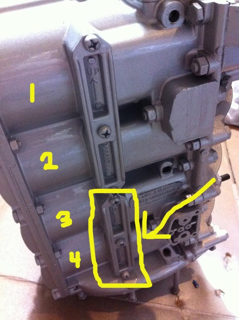

There is a Transfer Port Cover on the starboard side of the block that gives you a good look into the cylinder. Remove the screws holding this down and get a look in there. Use a small screw driver and gently push on the rings. They should spring back freely. If you see any scoring or damage inside or if the rings have no spring let to them you're looking at a tear down. Let us know what you find.
This is an early 60's 44ci block but it gives you an idea of what to look for. Pic below it is a #4 scored due to water intrusion through the lower seal. Checking for a wet or really clean (steam cleaned) spark plug can give you an indication of a bad lower crank seal.

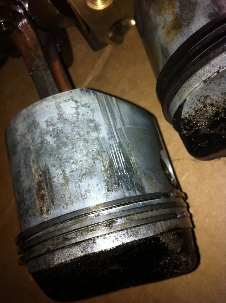

So I just though I would show some picks of what the #4 piston looked like on the 1970 mercury there really deep burn/ grooves. Right across the rings (the reasons there was very little compression) so what caused this? The other pistons are a little groves but now where near this one

This is typical damage of a motor that is not run properly .----Running with an old worn impeller.-Poor quality oil.---Lugging the motor with the wrong propeller for the boat etc.------No nicasil back then...Suggest boring it out and fitting new o/s pistons.-Might be cheaper to find another motor.

Looks like shes got a bad lower seal and possibly some pre-ignition.

Here's what's left of the lower bearing where did the rest of the ball bearings go? Any chance they could of got into the 4 cylinder and cause all the heavy scoring? And yes if your talking about the large O ring it was toast very brittle
