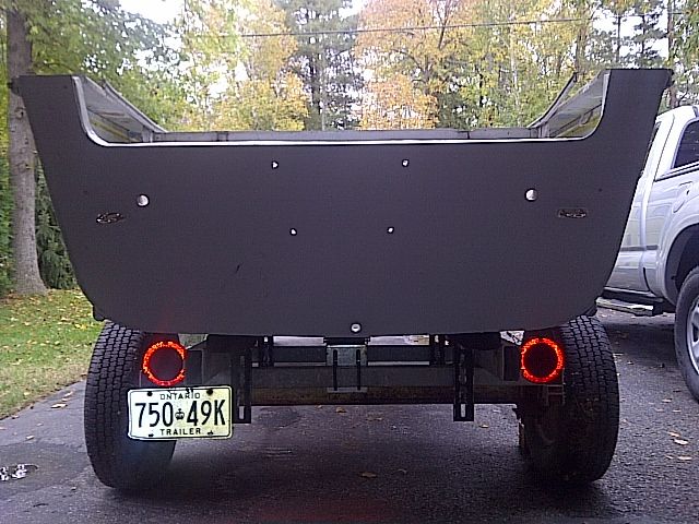

Well got all the pieces installed. Something like this >>>
- drilled 1" holes in transom skin for splashwell holes
- installed splashwell using 1/4" x 2.5" carriage bolts and 5200
- installed transom cap and plate (had to use longer bolts 1/2" X 4") using 5200
- installed cmc
Exhausted now. Took a hole bunch longer than I expected. (kinda - LA boat never surprises me)
But feeling good transom is finally installed. I know she's real solid and hope there's no leaks.
Have to prepare for lake launch and final check for leaks. Fingers crossed! :)

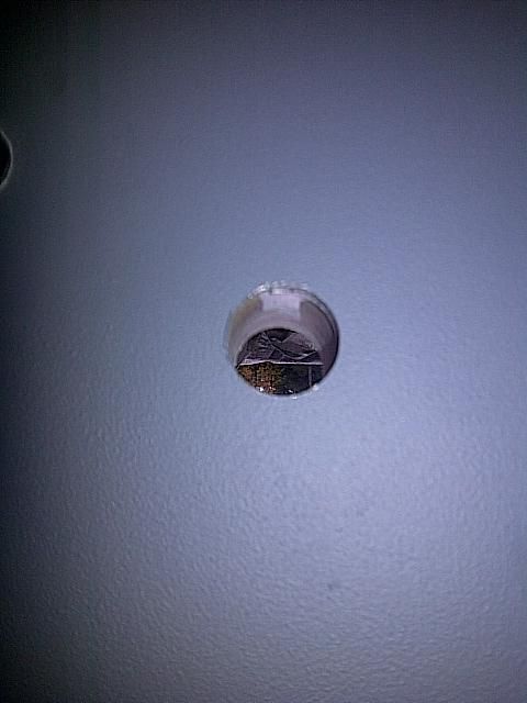

Used the flange tool for both splashwell drain holes. Starboard side went a little better than port side. The hole on the port side is located pretty much at the bottom of the splashwell. Of course this made it impossible to use the washer. Anyway both drains are installed and I am pleased with the results.
Drain hole from outside view.

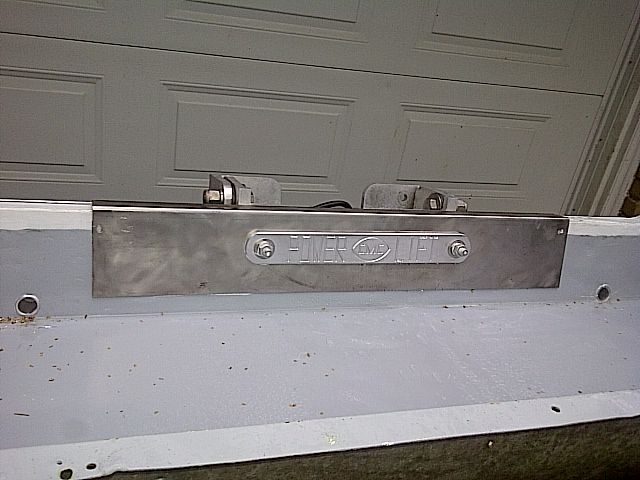

Ready for cmc
Followed the directions in the cmc manual and connected positive and negative terminals to a 12 volt battery charger. Just enough juice to raise the cmc to get at the ob mounting bolts.
cmc installed

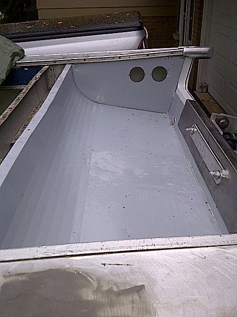

The splashwell was installed first. Proved to be somewhat tricky lining up all the holes otherwise installed ok. Used 5200 on all holes.
Splashwell installed
