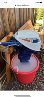

Hey guys so I just purchased a evinrude 9.5 1971. When the guy I purchased it from demoed it for me I noticed that it started fine cold start on first pull. Compression test was good, spark plug wires look brand new and plugs. Engine looks amazing overall like it has very low hours. It started to misfire a little bit then start running fine . Owner said the gas was a year old and it definitely looked and smelled old. Could this be the reason for this misfire ? Should I do a carb rebuild or just try to run some sea foam first to see if that clears anything up.

Some love those light weight ( 60 lbs ) motors and other loathe them.-----Start with doing a spark output test.-----See if both leads have 1/4" spark or more on a testing device.----These motors are famous for cracked ignition coils.----There are very few ( if any ) of these motors still running nice with original coils.----First thing I do on any of those motors , 1-1/2 to 40 HP is inspect ignition coils.----Usually find new coils.-----If they are cracked it might be a bonus as the motor has not been used a lot.

Saw a guy in the Home Depot parking lot with a trailer load of old motors and parts on it. Spotted an Evinrude 9.5 in the jumbled mass. I waited on him to come out then approached him asked what he was doing with all that stuff. He said he was headed to the scrap yard. I asked him what he wound take for the 9.5 and he said if I wound help him put the sheet of plywood he had in the truck, I could have it. Well, I got it and had it running in a couple of hours. It had a miss so I pulled the flywheel again after I had clean and set the points. I pulled the coils out and found they were cracked on the bottom and arcing to the magneto plate. I replaced them and reset the points using my ohm meter and now once it's warmed up, I can crank it by spinning the flywheel over with my hands. Very low hour motor. Crazy how some people are. Said he was cleaning up at his dad's house that had passed away. I could kick myself for not asking about the 20 hp mercury he had on there as well.
