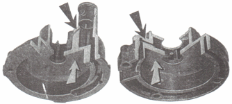

remove the gc & spin the drive shaft in the bucket of water .... make certain water gushes out of the impeller housing... if ok work top side
reinstall GC align the water tube
if not.... check for water restriction into the GC water intake cavity below the impeller housing
