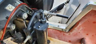

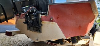

Hello everyone,
First time boat owner here. Picked up a 1971 GT160 with Force 120 outboard for next to nothing and trying to give it a once over to be enjoyed for a cheap boat challenge between friends and hopefully a couple of seasons depending how it holds up.

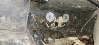

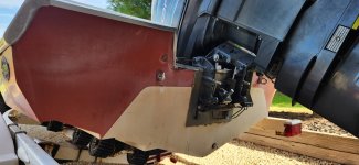

The transom is a bit soft and has been reinforced with aluminum plating by a previous owner. As a mechanical engineer it passes the sturdy enough sniff test for the moment/for my purposes and accepted level of risk, but I'll be watching it closely after a shakedown and each subsequent use (also will be adding/making a transom saver for trailer to help delay the inevitable)
On a likely related note can somebody tell me what this hole is for? Located just forward of outboard midway on transom. I thought it was a drain that allowed trapped water out the back of boat but after cleaning it out it is a blind hole... Do you think this was originally a through hole on the Glastron that got covered up when the force motor was fitted? Any ideas would be greatly appreciated, as it sits this seems to be a place for water to collect and rot the wood out only and I'm trying to determine if I should create a exit path in this location? Thanks everyone.

That's the splash well drain. All outboard boats have them

As an engineer and a realist, the aluminum plate is a bandaid applied over a broken back/legs/etc of the boats skeleton. it may offer a bit of comfort, however it wont keep the motor and transom attached to the boat unless there is also aluminum plates sistering the stringers and knee braces going forward holding the engine to the rest of the hull.
Look at the load path of an outboard motor compared to an I/O. the outboard motor is constantly trying to pry the transom off the boat with a long lever arm
Now relook at the aluminum plate.

I agree it is far from ideal but there is more going on inside the hull and at the rear than is shown in that one picture. I will take your advice though and have another look at potential sistering. I will try to get some better pictures and follow up. While I'm fully prepared for this boat to need to be limped back to a trailer and decomissoned, if the outboard ejects itself on the water that's obviously a much worse and different problem to have with implications I'd rather not have to encounter.
Can someone please tell me if the splash well drain is supposed to exit out the back of the boat straight through transom? It has to correct?

Ayuh,..... Welcome Aboard,...... Yes, straight out through the transom,......
What that hull needs is to be torn apart, 'n the transom wood Replaced, as the internal rot is way past sistering,.....

regardless of the motor on the boat, that transom started rotting about a month after the boat first came out. the encapsulation around the lower drain hole is abysmal. regardless if the splashwell drain was there or not.
Im with Bondo, a good TOP on that boat (with a good transom/stringers/deck) would be a fun ride.
boat restoration isnt for the faint of heart or wallet. that boat will cost you about $2k to restore the hull if you do the work yourself. expect to put in about 200 hours if you do the work yourself.
if you have to pay someone to do the labor, that is $120-$150 per hour for well over 100 hours of labor to do it correctly.

On the first photo, where the motor well is shown, it appears there's any number of cracks between the well and the inner transom. Then add in the hodge podge half-baked aluminum/sheetmetal reinforcing that looks like its slowly being pulled through the transom....
If that were mine, I wouldn't be stepping foot on it until it was repaired.

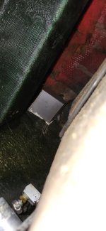

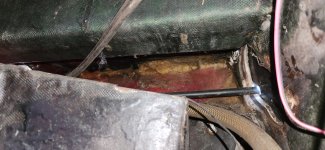

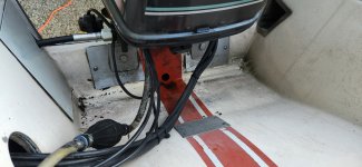

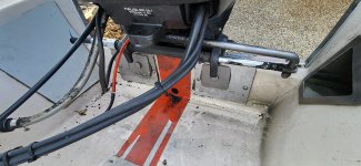

I'm a bit scared to post these here because I too have eyes, but I feel there are some people that might enjoy being validated in their clearly accurate observations haha.
Fix or replace... fix or replace...Thanks all for the hard truths. Time and lack of maintenance is cruel to all the things we love. I'm no stranger to sinking way too much money into old things, so hey what's another money pit. My only consolation is that for what I paid, I pretty much bought a decent running 120hp motor and got a free boat with it... yeah, let's go with that... and for those following from the start there is clearly NOT enough reinforcement nor would any amount truly solve the problem in any long lasting fashion, I will eat my words and agree that this thing is a ticking time bomb.
