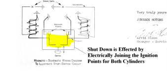

Hi all I’m new to the community. I just picked up this motor for free and plan on trying to get it running. It’s a Johnson 25. Checked compression on both cylinders and they are at 125 so that’s good! My next step is to get spark but I have ran into a problem. The motor is missing the Kill Switch/off button. I am not getting spark in either cylinder when pulling the cord. Is this because that part is missing or is it something else? And advise would me much appreciated. This is my first time with a Johnson so it’s a little different then a mercury. image.jpg
39,909
Find the 2 small black wires coming from under the magneto.----They should not be connected.-----Remove flywheel and inspect coils.

Buy any old brand of outboard switches with a man overboard tether and upgrade it. No one should have to see their boat fly away from them.

you sould pull the fw anyway to check coils...easy fix if all cracked like picture
change plug wires and boots to ! capacitors likely dead pointscan be "touched up" for a test
refurbish which you should do runs about $150 in parts
coils... points,,, capacitors,,,, carb kit ,,,4 feet of solid metallic strand wire (no carbon fibers) from your local motorbike shop or tractor place
