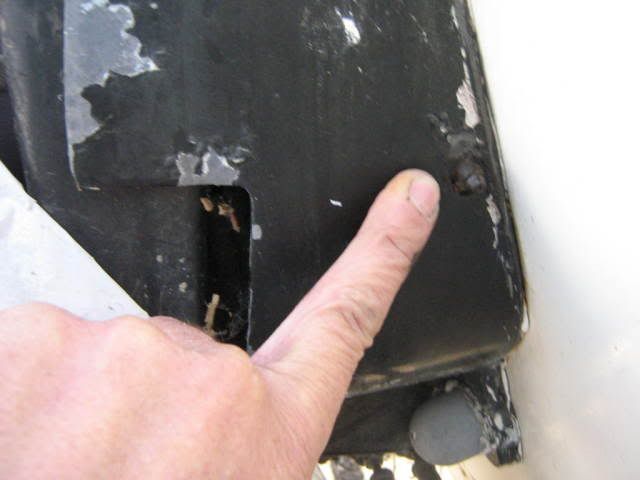

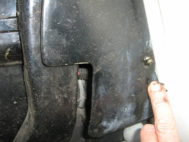

if you do have one, here's where it's at..
this one is a '72 1 drive. don't know if it was replaced, coulda been as much was repaired on this boat over the years..
same place on this one. it's a '75 1 drive. i suspect it may be the original one that came with the boat... though don't know that for a fact..
