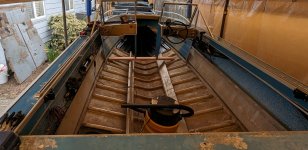

first board back in the hull, waiting for my extra long rivets to arrive to fasten wood to my 1/8 inch thick crossmember (replaced waffer thin factory one) old one toast.... good plywood is no joke, CASH was king bought some double sanded waterproof glue B grade from a lumber yard in WA for 25 buck ea. fair price for almost 3/4 inch, definitely no more sag, very stout!!! sealed up hull with COAT IT all seams and rivets attended to and then some!!! I will seal up the wood or roll it on at some point during the process but for now Im pretty happy with the progress... my neighbor (who gave me the boat) is thinking i woulda thrown in the towel by now, but im in way too thick at this point
