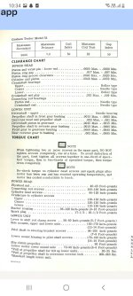

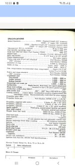

For anyone else that finds this thread in the future for a similar problem hears all the tec specs iv found

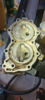

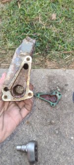

Core plug has completely **** its self glad I bit the bullet and ordered 1 the same time as the gasket just need to wait till Tuesday when they arrive now

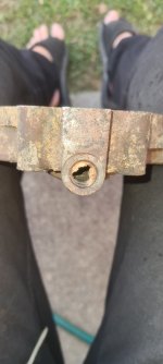

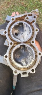

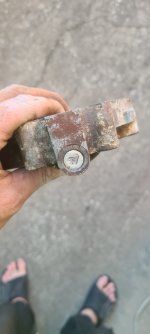

Got a question about the core plugs are the designed to be a weak point incase there's a pressure build up issue such as a blockage somewhere water can't get out so the core plug gives way instead?
I only ask as I was looking at my spare head with the striped sparkplug hole and someone went to alot of effort to seal it right up I'll post a pic
Is this a good idea or a bad idea?

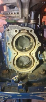

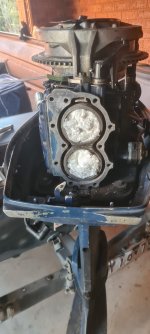

Well that's about as good as the old girls gonna get
I did tap the core plug a lil to hard but lesson learned gentle taps next time

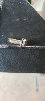

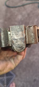

Well smacked the hell outta my knuckles and that hurt alot less than the knowledge of what just happened
I was only upto 80inch pounds of torque when it snaped so not even done upto requirements yet
