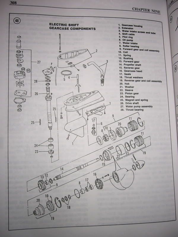

I can't seem to see where you are going wrong....here is a pic of your electric shift...
F_R
Jul 7, 2006
28,226
Re: 1972 65 evinrude triumph electric shift lower unit problem
I really don't understand the question either, but a couple of things come to mind
1 The picture posted by Saskatoon is not the correct picture for the motor in discussion.
2 Here is the correct one. If the thrust washer circled in the picture is left out, the propeller will jam up against the gearcase, causing severe drag and even worse, severe damage.

Mine must have been from a different year then...sorry....I have a terrible maunual, but it's gets me by. Good thing I don't have a 1972 65HP outboard.....LOL!

i was going to say thurst washer, till i saw Sas. picture, no nut, just shear pin. FR glad you caught that.
