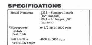

what is the mdl # of your 9.5 does it end with #3 like 9223

9822 left the factory as a short shaft. But that doesn't mean a hill of beans. It may have been converted to a 9823 (long shaft). You can tell the difference with just a quick glance. Does it have a 5" extension piece (# 62) above the lower unit gearcase (#14)?
