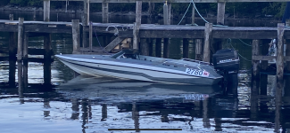

Sounds like a great wee package you got yourself. Like some of the older Glastron. Big fan. Enough to have a very rare UK made Roger Clark built cvx16. She has a big merc v6 2 stroke on the back of her. Just coming up for 40 year old soon.
