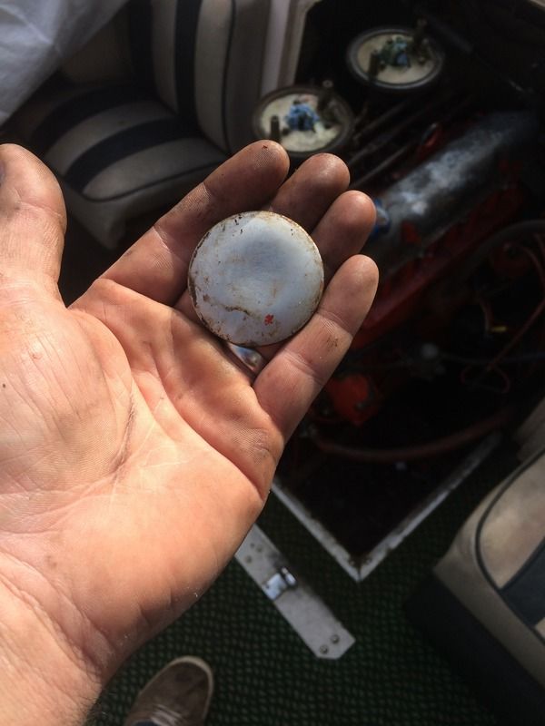

Got a little time into the boat today, not much accomplished really but
i reached to the far back of the bilge and grabbed a big handful of gunk and what felt like a big coin :p
i knew right away what it was :(
i have no idea how i missed this before guess i never had my head low enough to look
hopefully this is an easy repair ? ive never done one, will still continue to try and get it running

bruceb58
Mar 5, 2006
30,797
Hopefully block isn't cracked.
You likely have the B20 engine which looks identical to the B18 since its the exact same block but bored out more.
