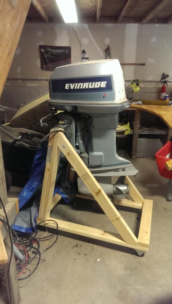

I also wanted to give thanks to the members of iboats for all the good ideas. Like this motor stand that works awesome

Hmm, I see an upstart cottage industry: Donor Glass transformation into Koi pond............. Anybody got TLC/Discovery channel on speed dial?
Nice work on the clean out & motor stand....

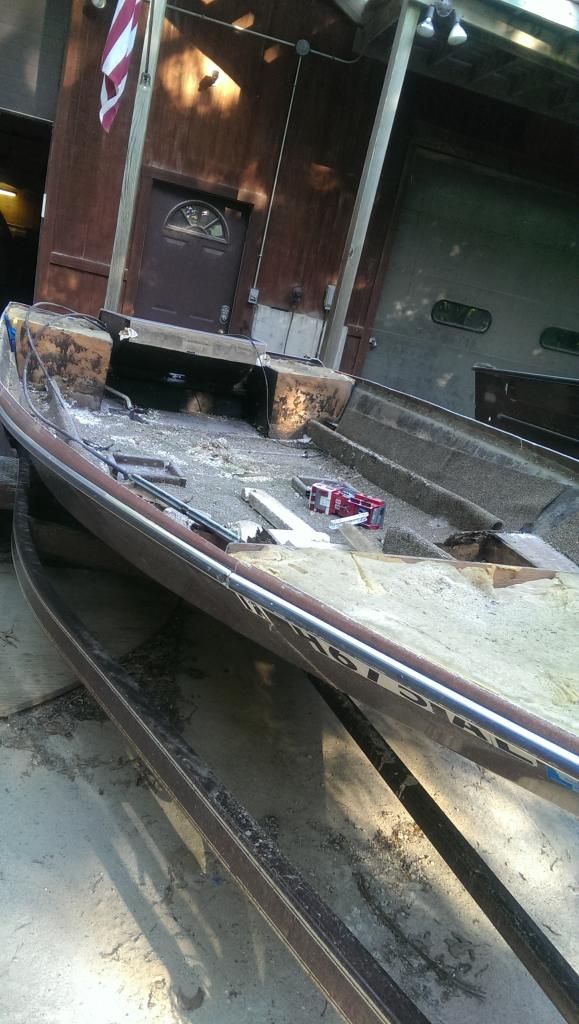

Repurposing a n old glasser just makes sense when the land fill wants a huge a mount of money or make you go through h@#l to get rid of it. Here's what happened to a rotten old Silverline doner I bought.

You killed two birds, Glen. Recycled some old concrete too. :smile:

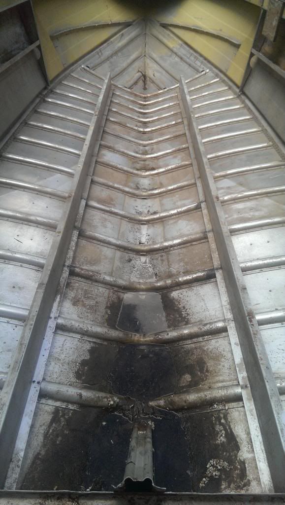

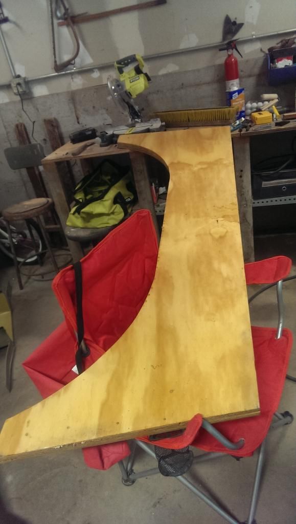

Gonna do the flip this weekend get her in the turtle position. After I finish cleaning all the sand out from under all the ribs. Do I need to gluvit first? My thoughts where to do it after bottom is painted dew to flex of flipping it.and should I put transom in before I flip it? I have the transom done and three coats of spare on it. Want to sand it test fit it one more time drill the holes and another coat of spare first
GA_Boater
May 24, 2011
49,038
Do the Gluvit after she keel down again, CH. Avoids the extra stress on the hull/rivets/Gluvit.
GA_Boater
May 24, 2011
49,038
Yes - I missed the transom question. Putting the transom wood in before the flip adds a lot to the structural integrity. I would install before turtling the hull.
