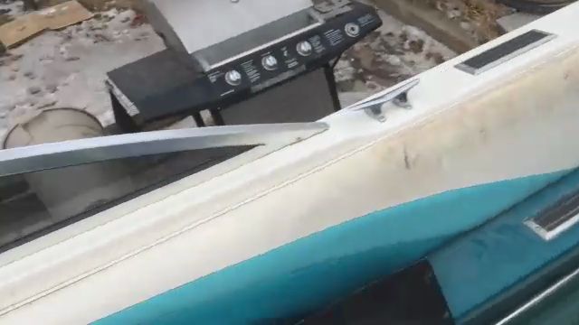

A few shots of my latest project nearing completion
[URL=http://s1235.photobucket.com/user/boatnut74/media/FFFD9191-6E06-47F7-80B1-C117877A019E.jpg.html]
[/URL]
