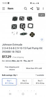

And I'm sure rebuild kit is cheaper then new pump, do you think rebuild would be sufficient?
KC9000
Mar 28, 2021
116
Would this fix a qeak pump? Or would I need to get a new pump?

i've had decent luck with those cheapo aftermarket pumps... just be careful not to over-torque the mounting screws as they will leak. but a rebuild kit is fine, too. just takes more labor as the new replacement pump is same price or cheaper.

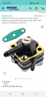

Like one of these, if its clearance issue, I can just swap the base of the current one of the engine.

39,369
About the only thing that can go wrong with the fuel pump is the diaphragm $6.00 or so and dirt on the check valves .----Easy inspection and fix.----Otherwise you are not learning by " trying " another pump !

Yeah I was thinking about the rebuild kit over the new one, I took this one apart once already and inspected the Diaphram and check valves and they looked like they were in good shape, buy never hurts to throw a 6 dollar Diaphram in just to be sure. I love the advice!!

Factory kit comes with instructions .---Guaranteed not to be " chinesium " parts.---Fix it right the first time.-----And really the diaphragm is the only thing that fails !!!----Available $4.54 as a part by itself.
39,369
The diaphragm may not be listed for your 1973 model.----But there is a list as long as your arm (200 models or so ) of motors that use the pump and that same diaphragm.
39,369
That pump was first used in 1968.----Used as late as 2007 as well as a modified version and as a vapor extraction pump on the V-4 and V-6 model up to 175 HP
