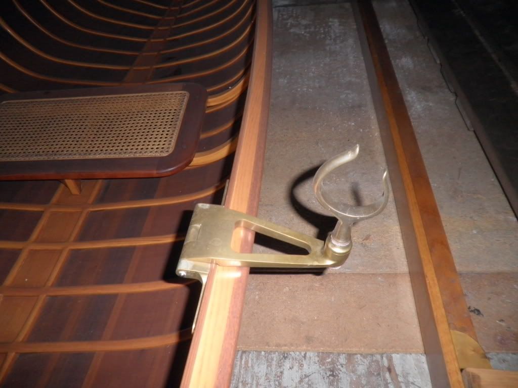

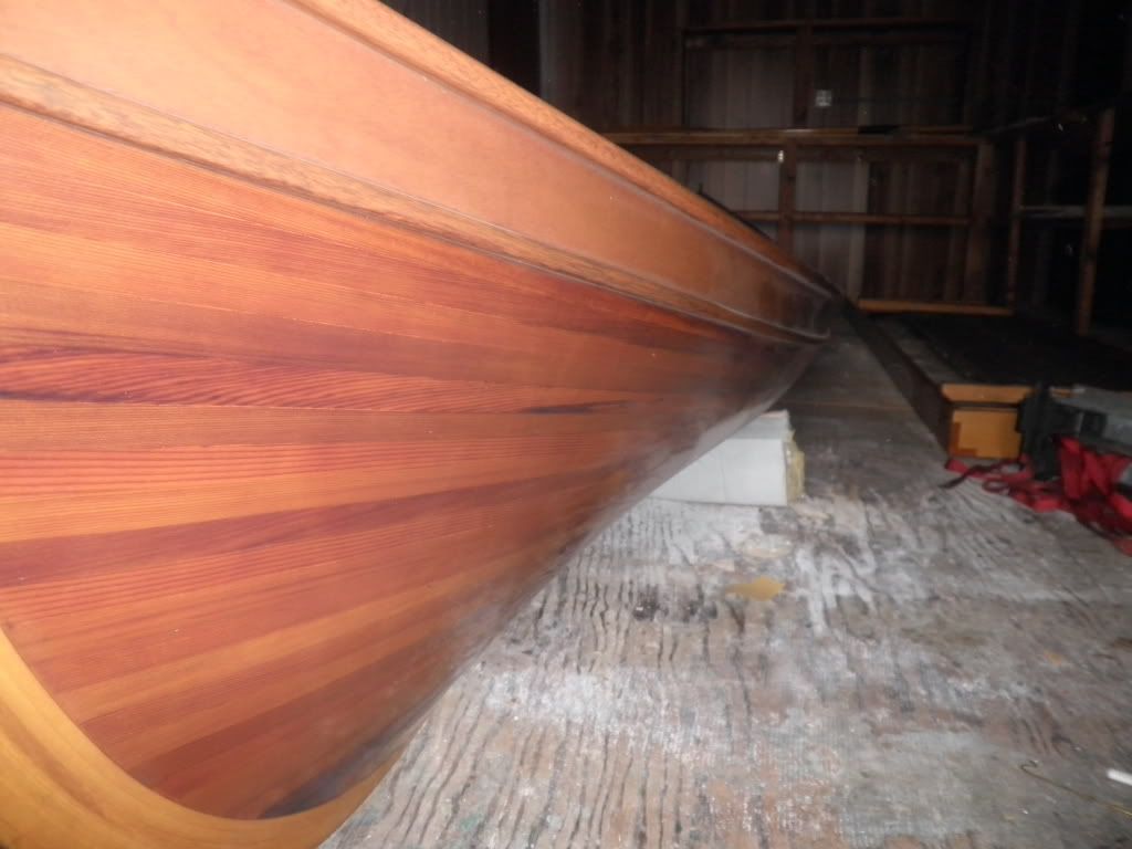

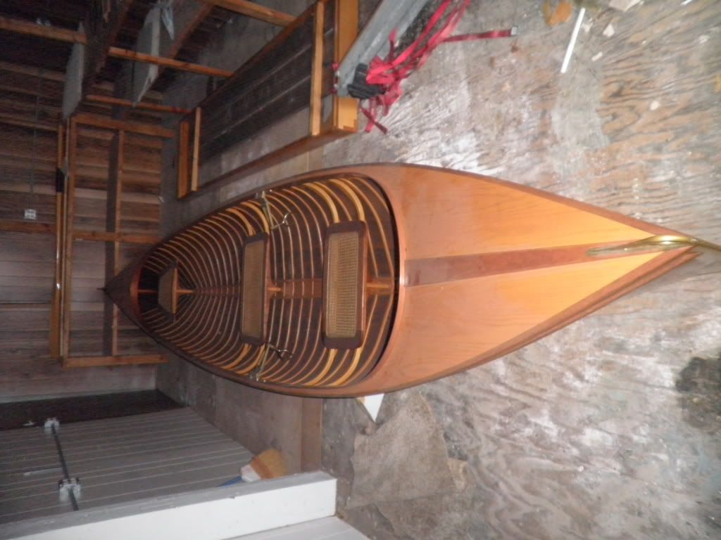

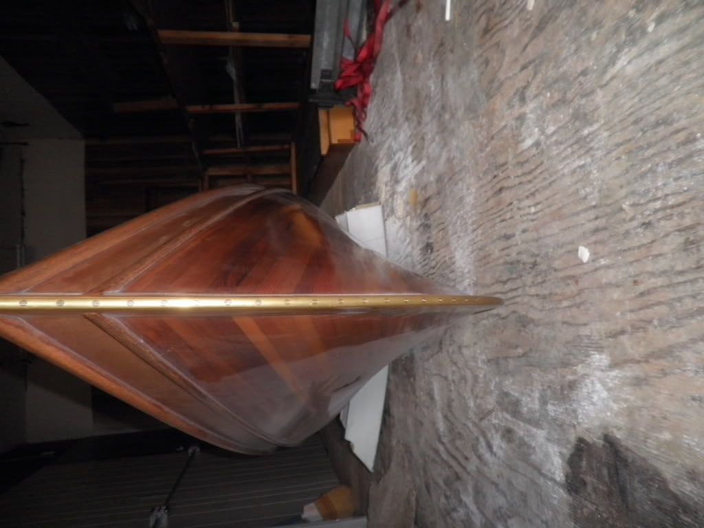

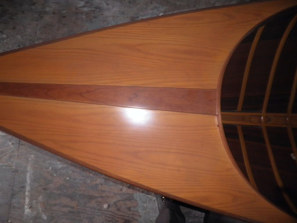

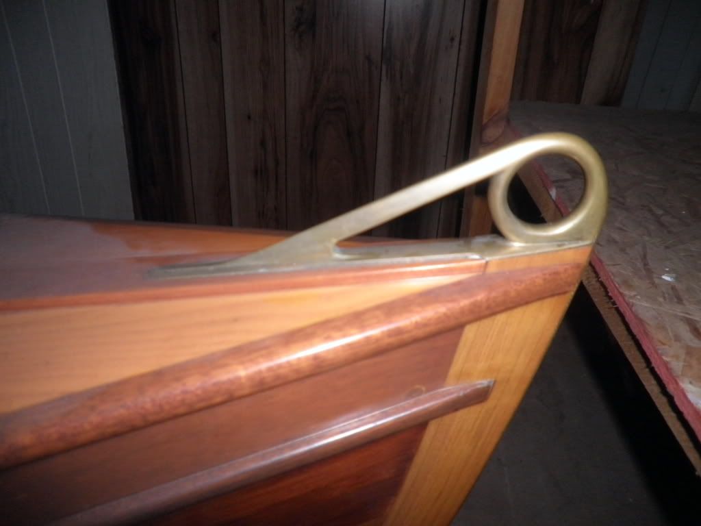

Re: 1973 18' starcraft starchief V

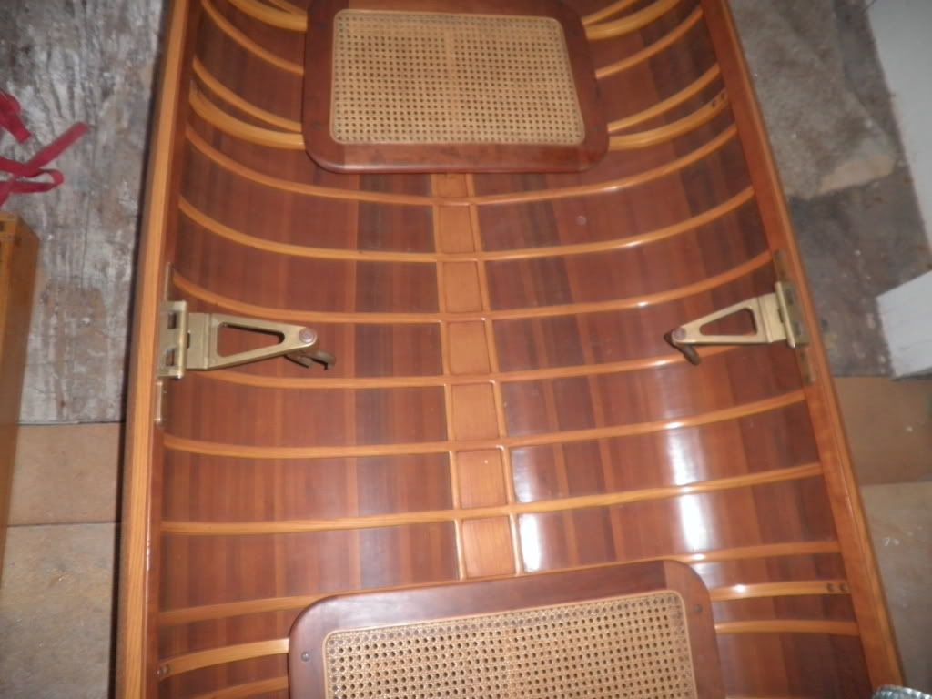

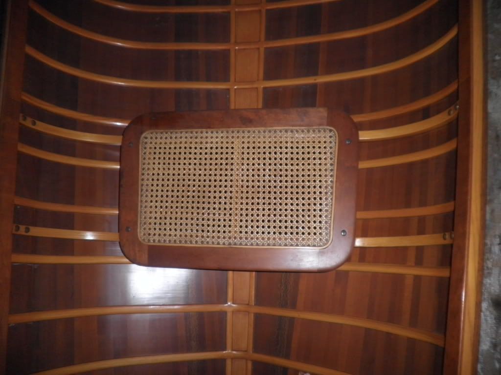

Well I finally got around to taking pics of the last project. It is based on an 18' saint lawrence river skiff. This project if i remember right took three years of weekends to finish. The oar locks, the eyes on the bow and stern and the caps on the stems are made out of brass and home made. The rest of the boat is made out of ash, red cedar, cherry, mahogany. Looking to sell the boat so if anyone is interested get a hold of me, like to get 5,000.
That skiff is absolutely beautiful!
thank you jasoutside. I almost hate to sell it but I dont use enough.
Hey brig, maybe I'm not seeing the photo quite right but are you going to be able to reach the steering wheel from where you are sitting at the helm there? I think I can see one of the console side brackets, seems like a log way off.
That skiff is totally awesome. Those brass hand forged fittings are just sweet!
the pic is just deceiving both of you. Also, keep in mind that i have about three inches that i can adjust the seat from the position that it is in and i can move the steering shaft out i think another inch and have from where i plan on mounting it if need be.
The brass fittings are not forged they are machined
Brig, that skiff is one fine piece of work.:)
What length is it? Can you paddle it like a canoe as well, or is it way easier to row it?
It is an eighteen foot boat. Never tried to paddle it cant imagine that would work out very well. It rows very well and is pretty fast with only moderate power applied to it.
What more can I say about the skiff exept its beautiful. The time and effort you put into it shows.
How did you finish the hull? Epoxy with some kind of UV protection?
The outside and inside of the Hull is covered in glass then varished over the top of that for UV protection. the decks are just varished.
